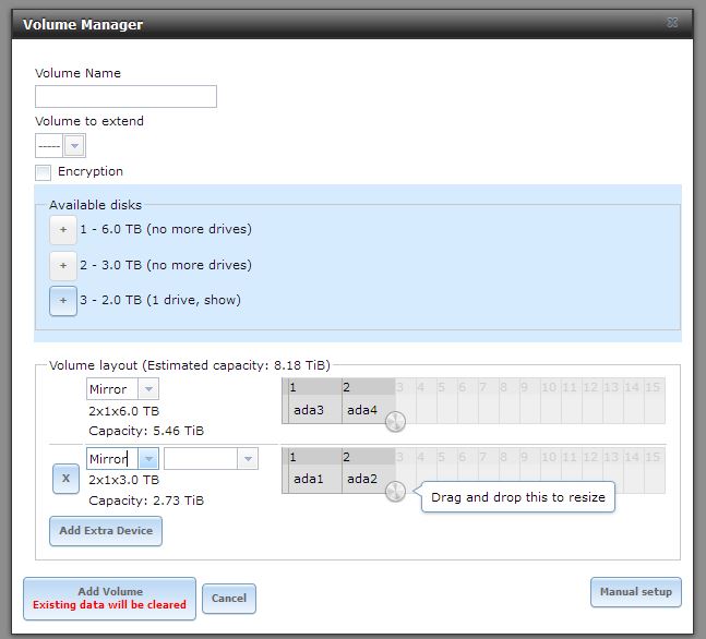

Ok, so now I downgraded to 11.1 RELEASE once again, but I am still not sure about which option I should choose...
I attached a capture of the volume manager - what should I select?
I know that striped mirrors optimizes for speed and creates a raid 1, but would this also mean that it would be more difficult to add another HDD for more space?

No, it’s the opposite. A mirror vdev makes it easy to expand as you only need to add two more drives. But you really need to read up on the ZFS Primer so you get the general overview of ZFS. Most users on the forum will argue for RAIDZ
Not at all. Generally is best practice to build a pool for the foreseeable future or at least add matching vdevs when growing a pool. The key is that (at the moment) pools can grow, vdevs can't*. If you wanted to add more storage, you could add two more drives and another mirror vdev. At present, it's not possible to add a drive to a vdev**.
Also you CAN add missmatched vdevs to a pool. Its just not advisable as you would end up with some unpredictable performance characteristics.
*The only supported way to grow a vdev in place is to replace each drive with a larger one.
**Unless its a mirror and your adding another mirror.

15,504
To get started - how would I go ahead and do this in my setup?
The screenshot above (the one you posted earlier today) would create a pool of striped mirrors.
