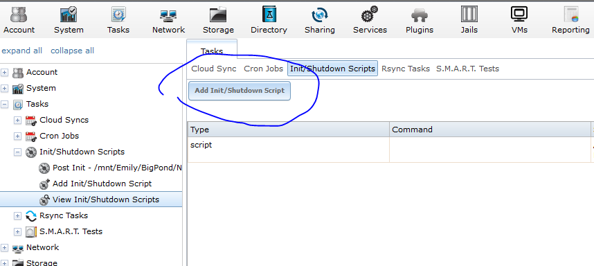

I think you are making a mistake to do this, but good luck. Click the button and it will pop a menu to point to your script.
