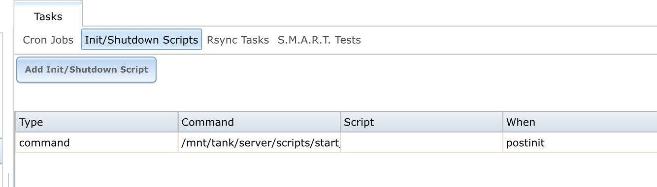

Now I’m curious...
Post init script. Command is tank/server/scripts/start_fan_controller
With the correct permissions. Key is I needed to make an executable script. See my fan controller thread for instructions.

The word "executable" doesn't appear on the first page of that post at least. What do you mean by "executable script", besides the obvious +x permission?
That's what I mean, but notice I execute the script as a command, NOT as a script. I'm sure I would've tried the latter, I don't remember the details... but why would I have done it the way I did otherwise ;)
