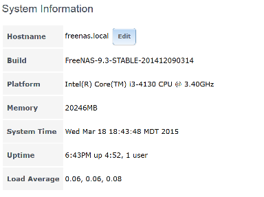

Hi I am pretty much an OpenBSD / FreeNAS noob, but I'm on my 4th or 5th server rebuild since my first try summer 2014. This is a home server, no "crown jewels" in the data.
I have a question about my setup and why my ZFS Hit ratio is so low.
I started with NAS4Free and then, when I had problems getting some jails up and running, migrated to FreeNAS.
Somewhere along the line I decide that the old repurposed machine I was using wasn't cutting it and bought a dedicated server. It made all the difference, and I couldn't be happier.
Anyway, I have a Lenovo TS140 server with an i3-4130 @ 3.4GHz. I have 20 GByte of DDR3 ECC RAM

Bidule0hm
Server Electronics Sorcerer
Aug 5, 2013
3,710
This thread is meant to post you ARC stats, not to ask questions about your problems (because the goal is to have a bunch of stats to analyse, not a few stats posts embedded in ten times more questions/problems posts...). I will still answer this time but, please, the next time (that counts for everyone) create your own thread (and just add a link to it here with your stats if you want), thanks ;)
So, it's not a big problem to have a hit ratio between 80 and 90 % instead of 90 to 100 %, it's just that you'll probably benefit of more RAM. If the performance is ok to you then don't change anything ;)
However your ARC, MRU and MFU sizes are very weird. I don't know if it's a bug but it must be (because 9.09 + 9.09 doesn't give 2.23... and the MRU size is exactly equal to the MFU size, coincidence?).
As an aside, please don't cut the list tags when you copy-paste the output, it's why the [*] aren't parsed by the forum in your post and the previous one too, thanks :)
Edit: I've edited the script to fix the "(adaptive)" problem, it should not be displayed anymore if you have a L2ARC ;)
Sean Coston
Member
Jul 25, 2014
128
Thanks for your reply despite my "forum etiquette indiscretions." I had just rebooted. Maybe the numbers for MRU and MFU are real? When the ARC is reset does it arbitrarily set them as the same dataset?
like i said... I'm a noob. don't hold it against me :)
Bidule0hm
Aug 5, 2013
3,710
Well, just after a reboot it's normal that the stats aren't great, it takes days (and even weeks on light loads) for the cache to warm up ;)
"When the ARC is reset does it arbitrarily set them as the same dataset?" this doesn't mean anything, I can't figure out what you want to say, can you explain please?
Sean Coston
Member
Jul 25, 2014
128
Just wondering if after a reboot whether your script calculates the MRU and the MFU as being the same because they are the same... there have not been enough reads to properly establish the values yet and the system reports the entire cache as both MRU and MFU.
But really, as you can see, I don't know enough about any of this to be able to speak intelligently about it. My apologies for confusing people.
