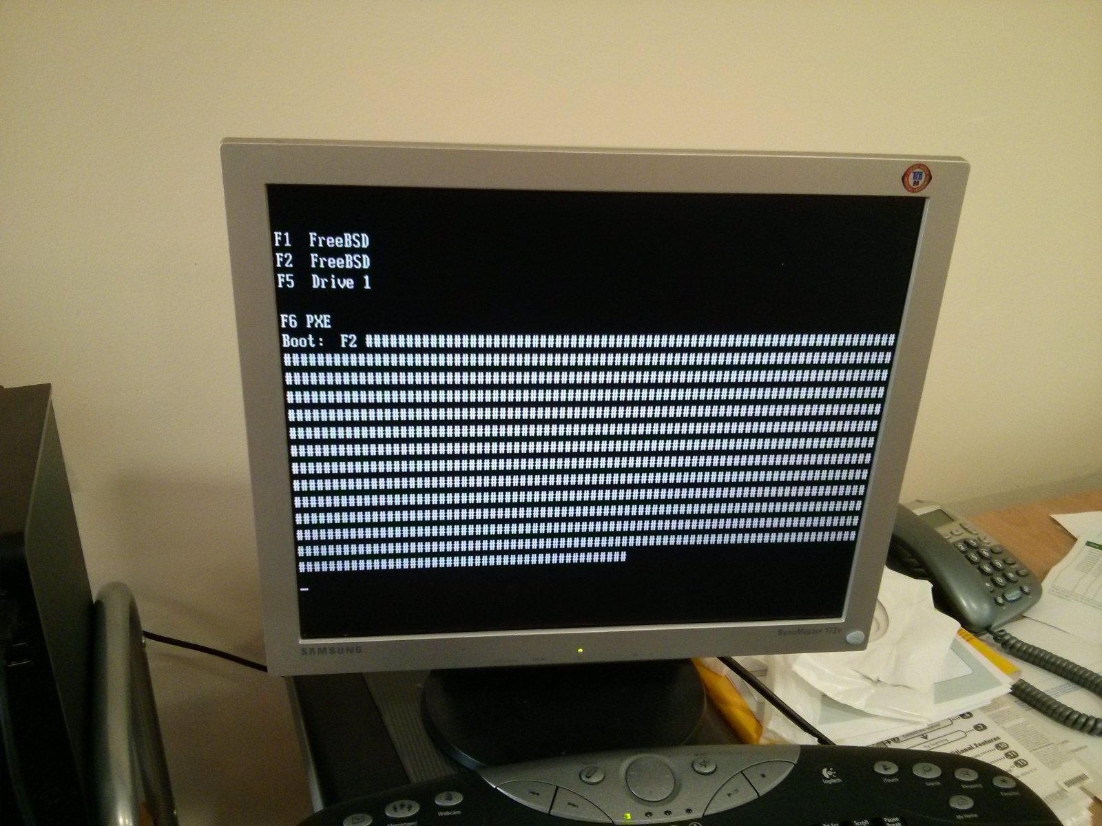

Just installed the RAM and have plugged everything back in again, but I cant find the FreeNAS on my network. I had the IP address set up as a static address, but it isn't active and I've been through all the attached devices IPs on the router and none are the FreeNAS.
Can anyone help?

This is what I get when I plug in a display...

In case anyone else stumbles across this. I just ended up formatting the USB pen and putting on the FreeNAS image again, then restoring my config backup. Seemed as though something had corrupted the USB pen.
All back up and running, with 16GB ECC RAM now, instead of 2GB.
