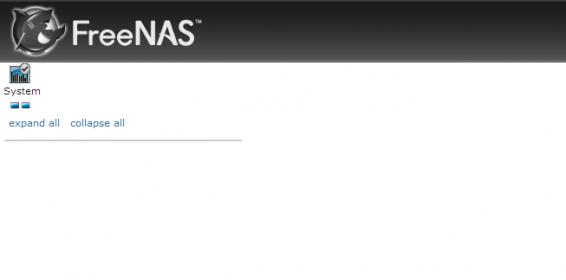

I've been running FreeNAS successfully on a HP N36L for quite a while now, most recently 8.0.2-RELEASE-x64. However when I recently accessed the web GUI for the first time in a while, the page was only half rendering as shown in the attached screenshot.
This was happening consistently in several different browsers (Chrome, Firefox, IE, Safari) on several different computers even after multiple reboots. All other FreeNAS features appear to work fine during this time so the problem appears to be limited to just the web GUI.

cyberjock
Inactive Account
Mar 25, 2012
19,526
Is my flash drive corrupt?
Probably. Get a new USB key and do an install on it and import your config.
Is it easily recoverable without requiring a re-install?
Sounds like you didn't read the manual on backing up and importing configurations...It is "easily" recoverable if you've backed up your configuration. Total recovery time.. about 10 minutes.
Do I need to do a complete re-install of FreeNAS (onto the same flash drive or a new flash drive)?
I would try a new flash drive if I were in your shoes.
