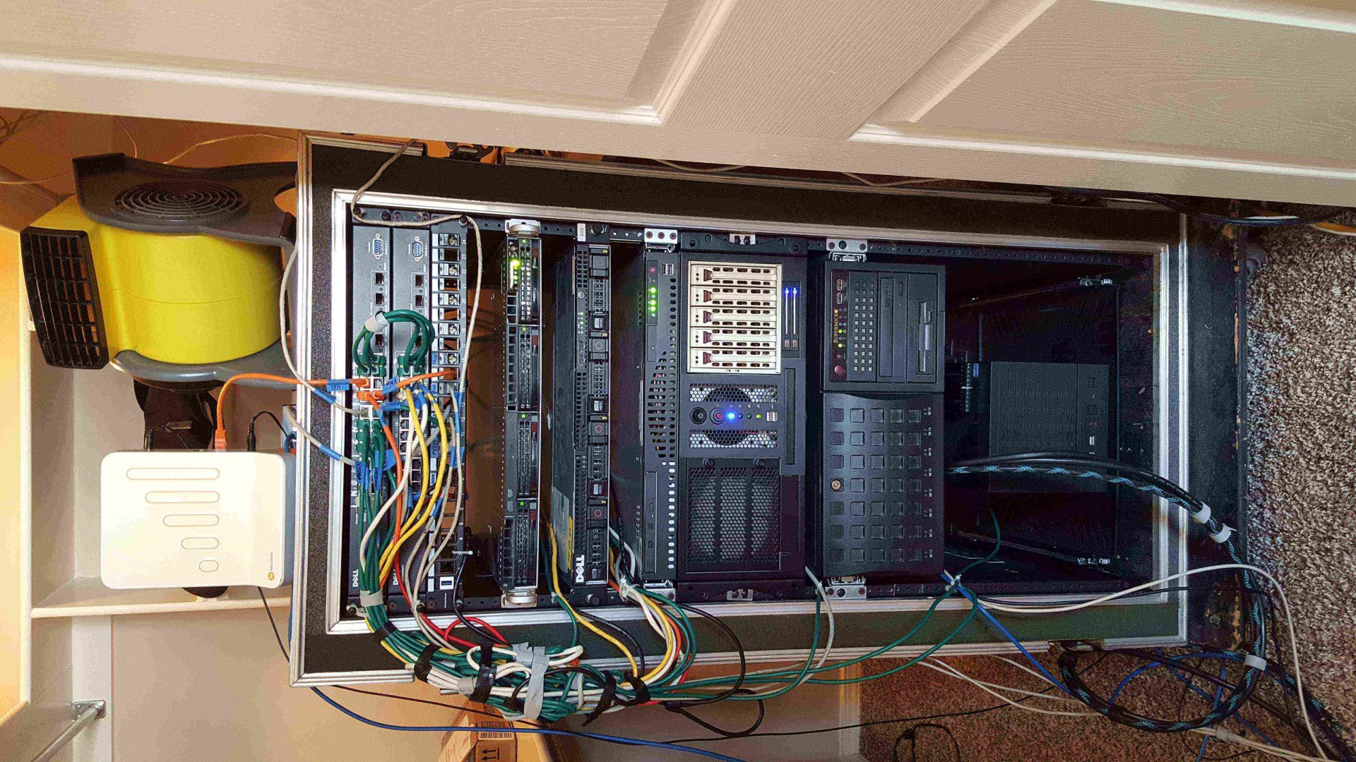

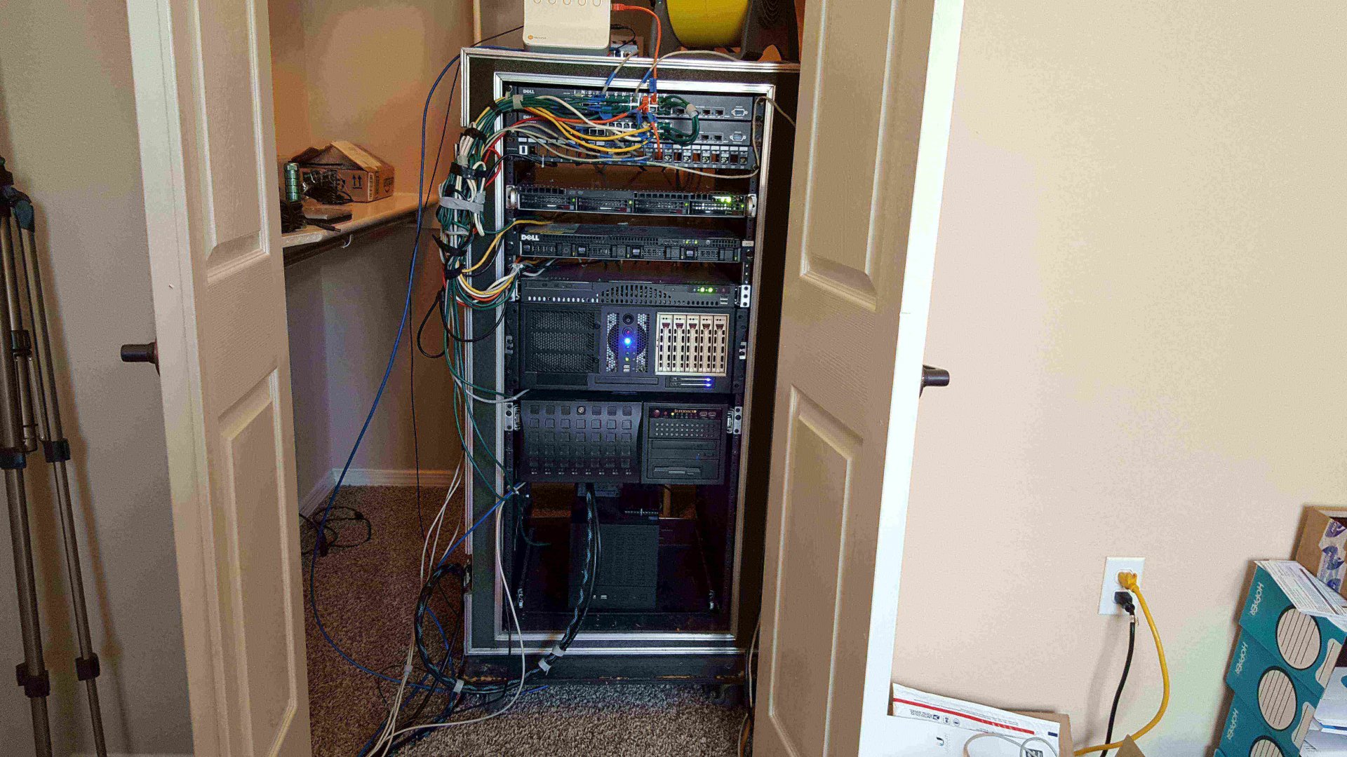

I have my red drives in a fully cooled server rack.
Where did they expect people to put these things at, I mean even consumer NAS units use fans?
How much heat and power is the drive head going to use? It cannot be much...its a drive head.
They wear the hell out of the head just to save this little bit of power?

Pics or it didn't happen (really I am just curious)... ;)
Here:
