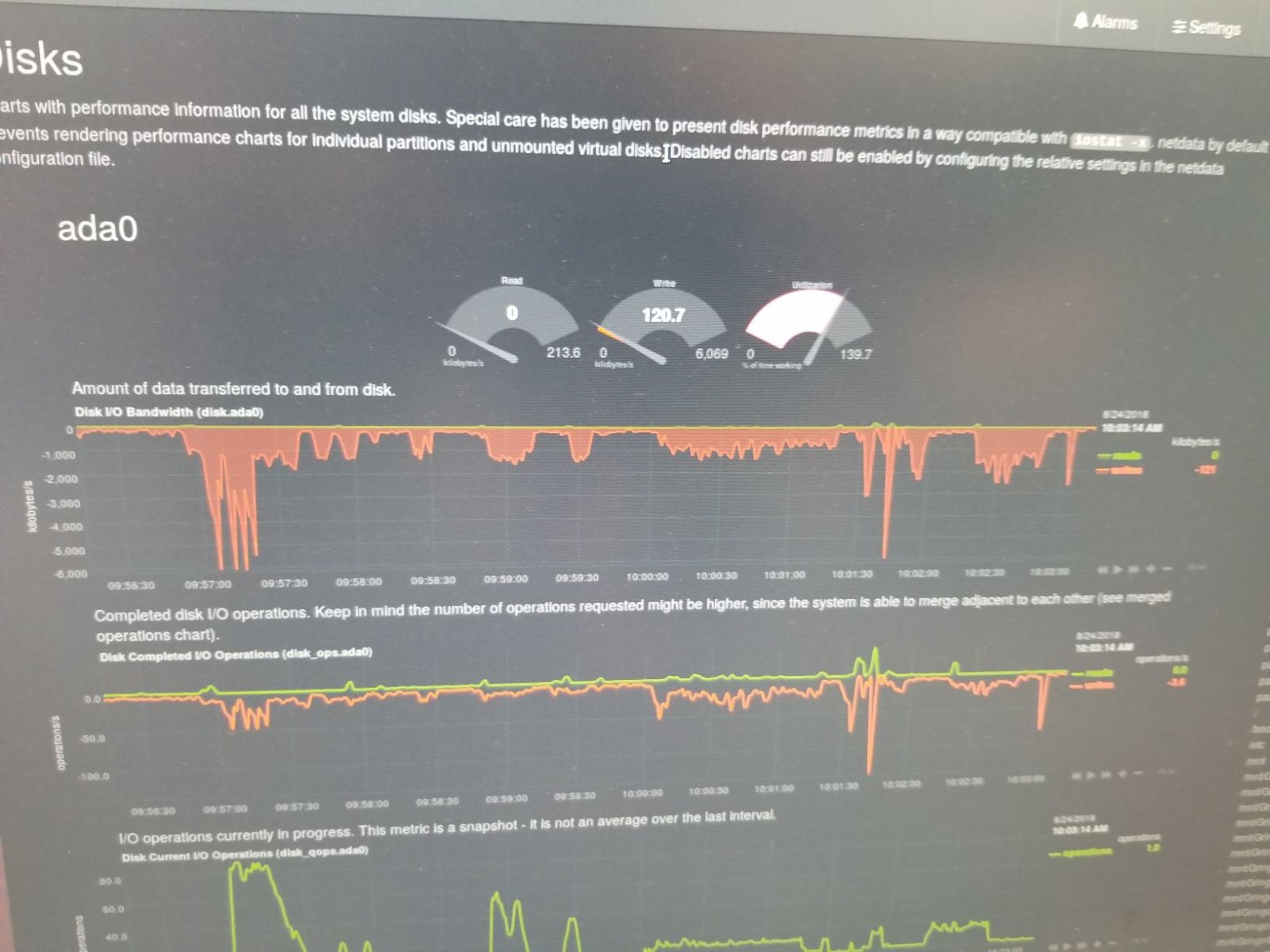

Hi all, wanted to get the collective intelligence on this one before I go spend more $$$ on drive(s).
I have a WD 3TB drive that is passing short and long tests but has utilization running in the 90's% with read and write in the 3 - 15% range (normal) and the system seems to be running 'slow'
System is 11.1-U6, 32GiB ram, 2 pools - pool1 6x2TB @ raidz2, pool2 3x3TB @ raidz1
I have seen this status for the past week and I am wondering if there are any tests that I can / should run before making a final decision.
Thanks all
Ian

How full is your pool?

I have seen drives run slow like that before in my system and it usually means the drive is about to die.
What is the brand / model of the drive and what does the SMART status show?
Edit - Sorry. I see where you said it is a WD Red.

Hi Chris.
Yeah, WD Red NAS drive 3TB. SMART in the CLI is not giving an error, that is what is confusing me.
I manually ran a smart test on the drive from the cli with the command #sudo smartctl -t long /dev/ada0
And here is some of the errors that I am seeing from the command #sudo smartctl -a /dev/ada0

As you can see - some read failures. I have ordered a new replacement drive but I would still like to know what is going on here.

I can't say for sure, but it would be my guess that the drive is repeatedly trying to read data from bad sectors.

Your NAS should have a big flashing red spot in the GUI about this. The performance of the system should not have been the first indicator that there was a problem. When a drive fails a long SMART test, it is time to replace it for sure. I usually replace a drive at the first bad sector.

Um, what is the question? You clearly have a failing drive as indicated by the fact that an extended test will not pass and fails in the same area. Replace the hard drive. Look at my hard drive troubleshooting guide link below for further information on how to read the SMART data.

Losing data is more expensive. Your disk is consistently failing SMART self-tests. Stick a fork in it, it's done.
