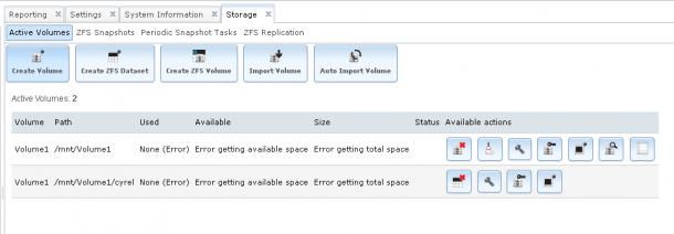

I'm using FreeNAS-8.0.4-RELEASE-p2-x64 (11367). Suddenly all my data disappeared. I think this happened after a power outage.
On the web console, the "alert" yellow icon is flashing. When I click on it I get the message box "WARNING: The volume Volume1 (ZFS) status is " and there are no other characters after the word "is".
In "view all volumes", I can see my two volume paths with "None (Error)", "Error getting available space", "Error getting total space".
Here is the output of some commands given in a ssh console:
