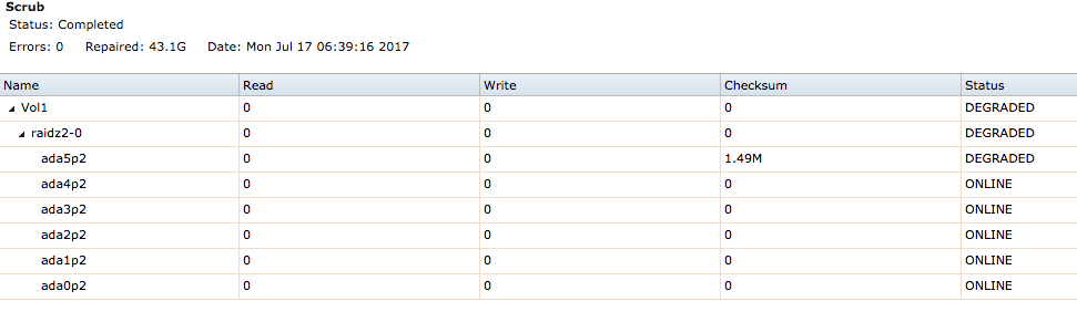

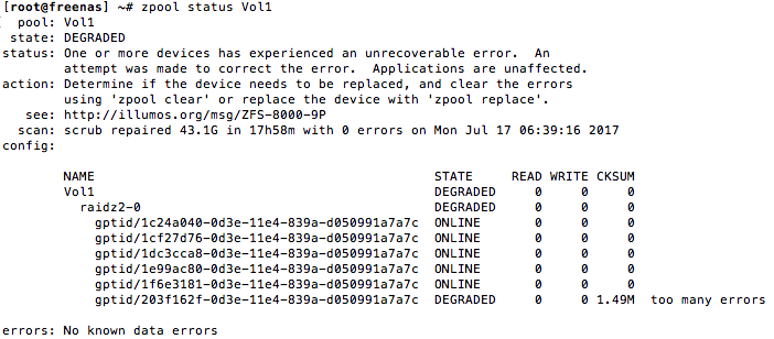

For a few weeks I've had an error saying the volume is degraded. I've done smart tests cleared checksum errors, and scubs with no luck on how to fix the issue. Please help.

zpool status shows the drive is failing but your alerts in the GUI show that diffident identifiers are shown at different points in time. Between warnings, did you move the disks around, reboot the machine, or change cables of any sort?
