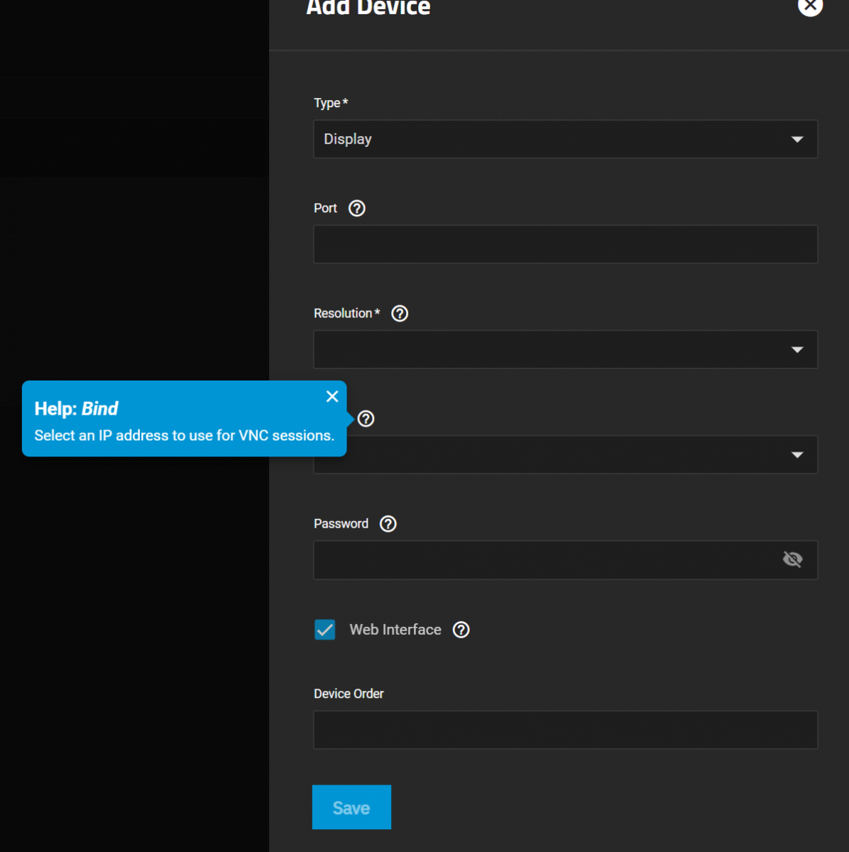

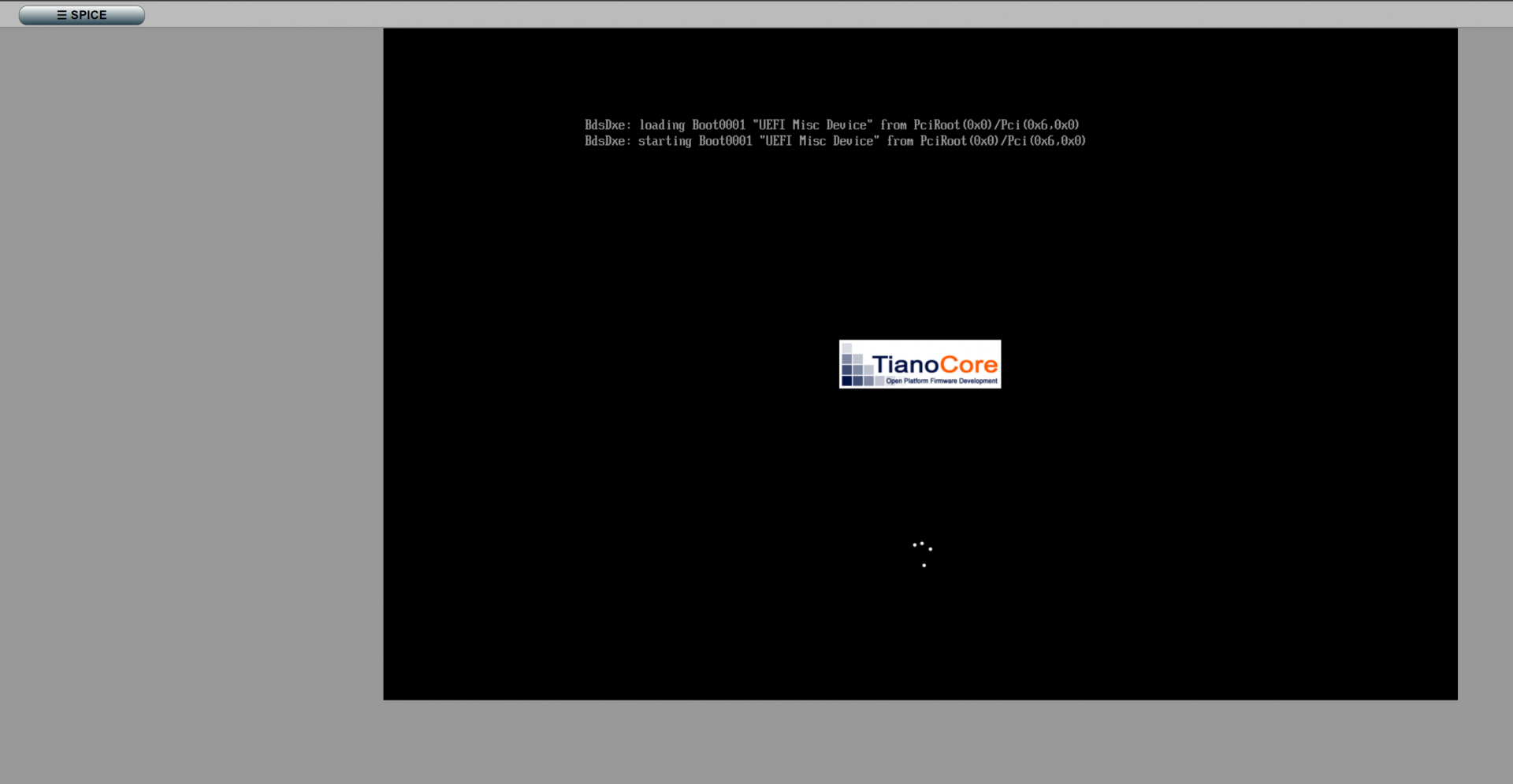

I upgraded to the Cobra beta a couple days ago. Overall, it's running well, but I was not able to connect to any of my VMs with the realVNC client. It appears that the displays on each of my 3 VMs were converted to SPICE. I was able to open the web browser spice display, but would prefer to use the VNC client. I tried deleting the display, went to add a new one and no longer see the option to choose between spice and VNC. Is VNC no longer offered as an option for VMs?

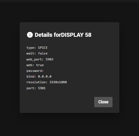

It has an existing display device, and it does sees to have been converted to SPICE.
For giggle and laughs, I can confirm that I no longer see the VNC/SPICE option menu (when adding a new Display Device after the VM creation Wizard), IIRC that was present before. But for sure, it always defaulted to VNC.

Sidenote: What's interesting is the tooltip reports as being the bind port for VNC, which may just be a UI artifact that wasn't caught in pre-BETA testing.

On lower powered clients at least, Spice outperforms RDP and VNC. I tried them all for some Windows apps that are heavily graphical. I could watch the screen paint with some heavy use for VNC and RDP, whereas it's like I am using an attached hardware display with spice. You can at least add a password to the display in the VM, in a home environment, security not necessarily as important for VM displays IMHO.

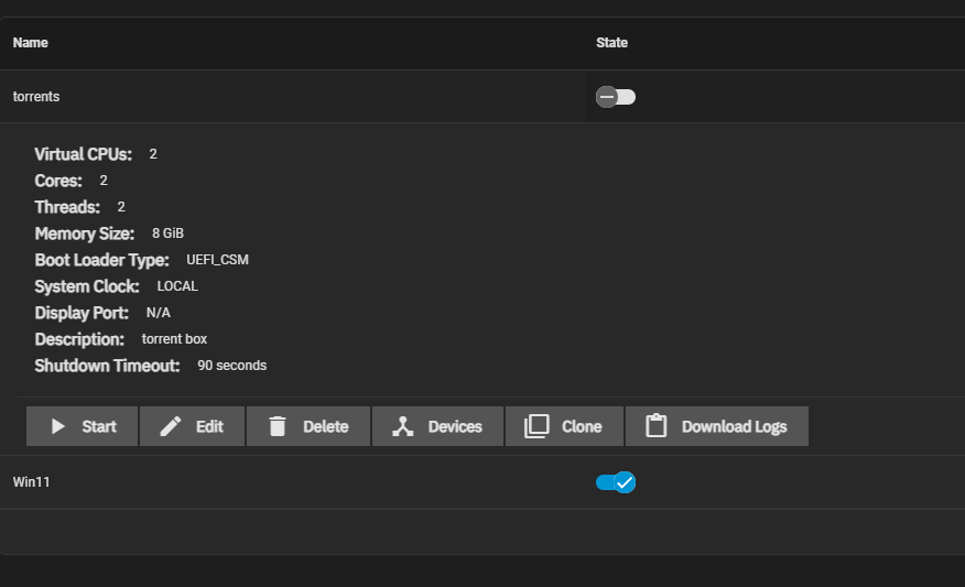

Mmm ok the button is missing, anybody care to run a crash course in "spice" so I can "see" my VM's again?

If you dont have this button:
It means you most likely don't have a display device for some reason. Go to devices
Press Add in the top right
and set it up

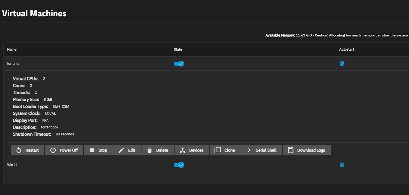

Mmm both of my VM's still have display devices, just the buttons are missing.

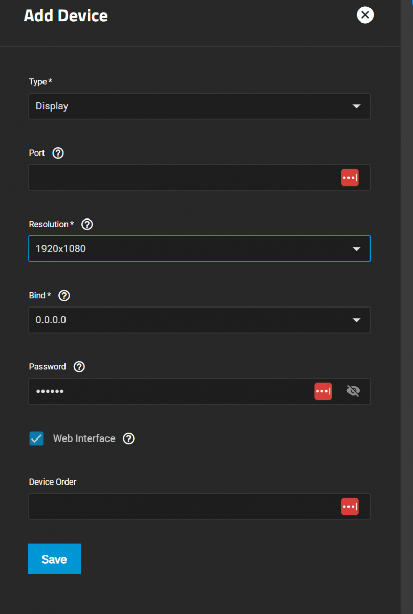

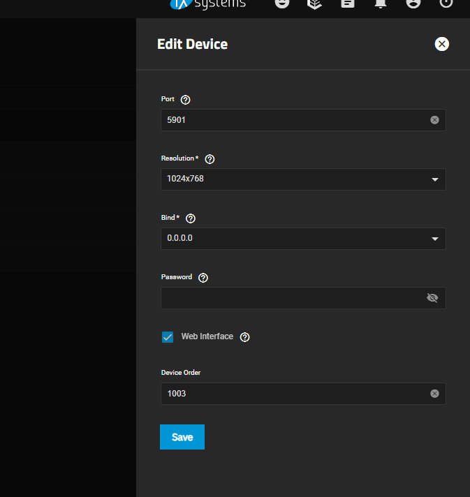

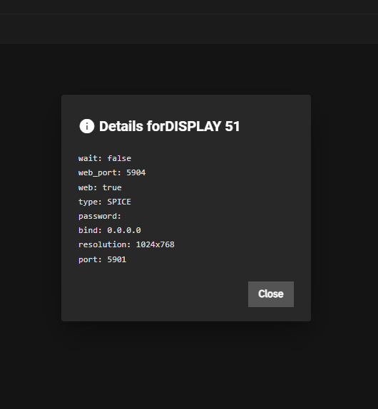

I just went and looked and my SPICE displays were not working. I notice they now want a password on the device. I just shut them down, deleted the device, added it back with password and they work again. They were not connecting or prompting for a password after upgrade from Beta to RC-1

I too deleted mine and added a password, but still no button, my vm's use 5900 and 5901 can anybody explain what the web address would be?
Also they both say there is no display port even though i recreated the displays?
The image suggests the VM is currently not enabled, I assume you have the same issue if you enable the VM?
Trevor68
Oct 15, 2021
130
Absolutely, I started a new thread for spice not working, seeing as it's not really the same thing as VNC being removed
