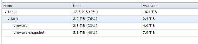

hi, can someone say how work storage|vmware-snapshots in 9.10.
I add, 2 host but not understand when will be snapshots?
i make 2 dataset, 1 for wmware-snapshot and 1 for wmware iSCSI. M.b. it's mistake and make one for iSCSI and do snapshot ?
toadman
Jun 4, 2013
619
Snapshots are part of the dataset being snapshot. You don't need the "vmware-snapshot" dataset. If you have a dataset on Freenas that is serving as a vmware datastore, then you setup a vmware snapshot in Freenas.
If set up, and freenas knows it has to snapshot the dataset, freenas first contacts the vcenter (or the esxi box) and tells it to do a vm snapshot for any VMs that are on the datastore in question. Then freenas snapshots the dataset. Then freenas tells vcenter (or esxi) to delete that vm snapshot.
This way there is always a "clean" copy of the VM state on the freenas snapshot.
