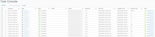

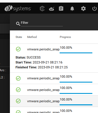

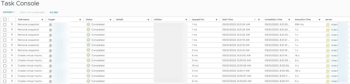

Snapshot creation and removal tasks are exactly what I see in my vCenter at the time the integrated snapshots are scheduled (screen shot attached).
Also, there are tasks that show up in the Task Manager in the array itself.
I'm using iSCSI and ZVOL's exclusively and have not tried this with NFS.
