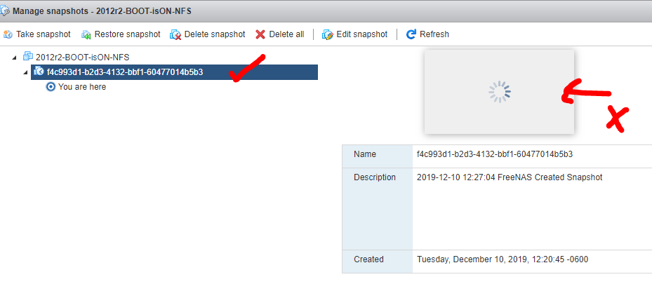

Problem: on esxi, revert to snapshot shows as "completed successfully" but the VM does not reflect that at all (the vm stays powered off).
more info:

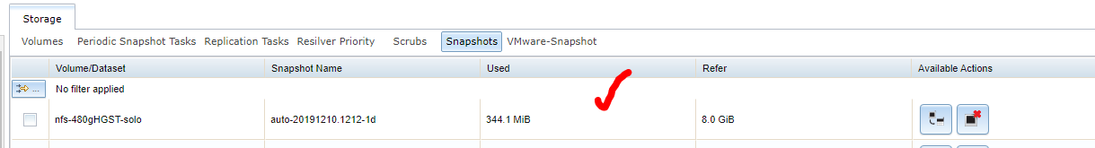

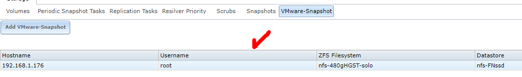

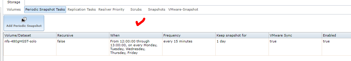

Everything seems to be working right, i see esxi take the snapshot successfully when FN instructs it to do so (ie when FN is running its snapshot of my dataset). However once i mount the clone of the snapshot, when i click on manage snapshots in esxi, i dont see the screenshot of the VM (see 1st image below)
If i powerup the VM, wo reverting to the snapshot, i get "why did the computer shutdown unexpectedly" (this is as is expected, as i just have a normal normal crash-consistent backup, as im not using the esxi snapshot)

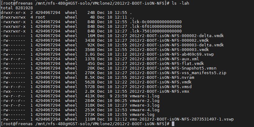

on freenas, the mounted snapshot clone:

Expected result- I should be able to clone a snapshot, then add that clone/datastore as a NFS share, connect it to esxi, (register the .vmx) and revert to the snapshot of the that was taken by freenas of the running VM.
FreeNAS by default (by design?) doesn't snapshot the running memory of the virtual machines. See this post for the code snippet from 11.2:
Quiesce files is expected to return to the "true" in 11.3 based on the bug report, but not memory.
Without snapping memory, you can't return to a running state.
