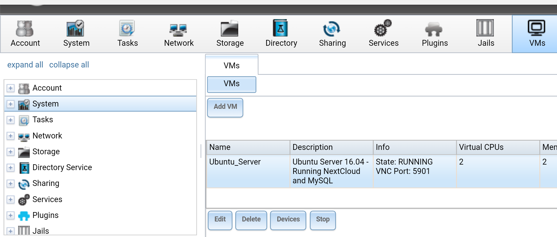

Hi everyone. Quick newb question. I'm running 11-MASTER-201704230409. How do I console into a VM that was created in the GUI? I don't see a Console button in the GUI so I assume that isn't built in yet, but how about in the CLI? I can SSH into my FreeNAS, I just don't know what to do from there. Any help is much appreciated!
m0nkey_
Oct 27, 2015
2,739
You'll need to have VNC on your computer. When the VM is running, you'll see a VNC address to connect to. Connect to that and you'll be attached to your VM console.
Apr 23, 2017
6
Thank you for your reply! Where would I see the VNC address? When I look at my VM list in the GUI, it gives a VNC port but no address.

Check your router to see if it's listed in your DHCP leases.
Apr 23, 2017
6
It doesn't look like it's getting an IP from DHCP. It's most likely sitting at the Ubuntu installer since the ISO is mounted and the virtual disk is empty. That's why I was hoping I could console to it somehow.
Apr 23, 2017
6
I tried VNC'ing to <IP of FreeNAS>:5901 (In my case, 192.168.10.200:5901) and it says "The connection was refused".
