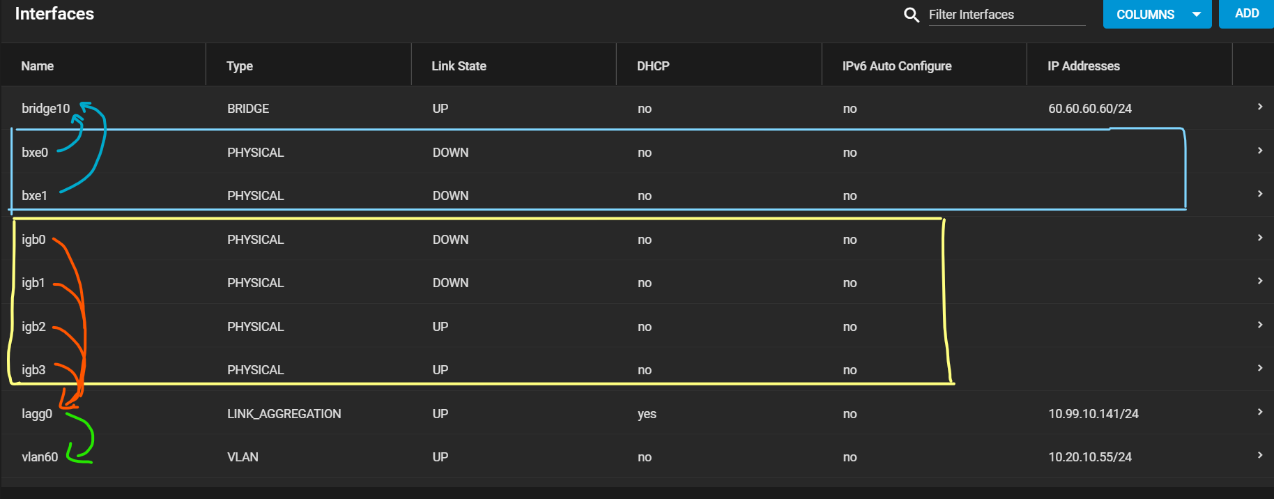

I've been trying for a few days to have my TrueNas box have its main Interface communicate over a VLan.
The current configuration is a 4 x 1Gbps port LAGG with DHCP enabled.
I've tried to set the VLan directly on the Lagg with ipconfig options but didn't work.
Then I tried to set a "Vlan" on the web portal and enable DHCP on it and also didn't seem to work.
I'm still not sure where is the issue, if on TrueNAS, the switch or my router, but wanted to ask a few questions to understand what is the expected configuration on TrueNAS side:
Thank you for the help.
- I've read on an old post that with FreeNAS, you need to have "NICs -> LAGG -> VLAN -> Bridge" even if the bridge only contains the VLan, where the Bridge is the one with DHCP, is this correct?
 - I've also read that the web portal will only respond on a single IP, is this true?
For example, currently I still have the LAGG with DHCP, which is working, however I also have configured the VLAN and the Bridge with a static IP.
More detailed, I have 2 IPs on the same Nic:- NICs -> LAGG with DHCP
 - NICs -> LAGG -> VLAN -> Bridge with static IP on another subnet.
- How can you issue a DHCP renew on a specific interface?
I've been essentially setting a static IP and changing it back to DHCP all the time as a workaround to test connectivity, its time consuming. - How can I manage Bridges?
The CLI allows us to manage almost everything, from Interfaces, Laggs, VLans, but not bridges.
One of the things I was thinking on trying was turning off DHCP on the LAGG and enabling it on the Bridge if question 2 above is correct.
