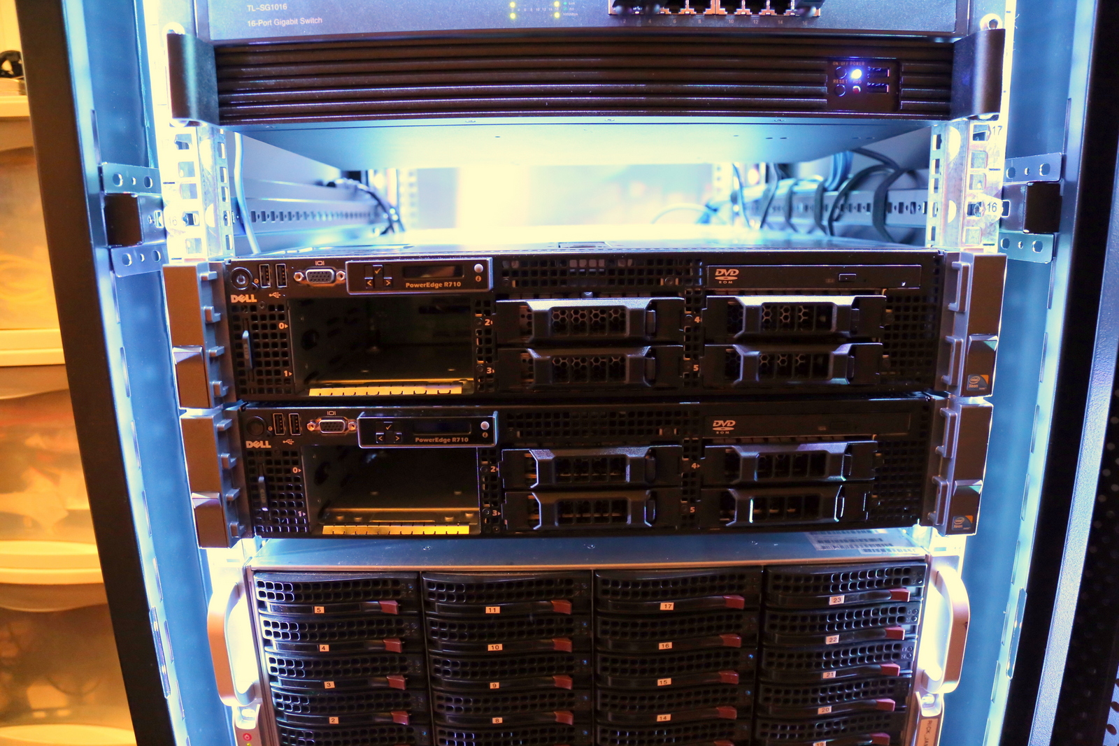

So I ended up getting a pretty good deal for 2x Dell R710 for $296 each. They have dual PSU and rails which is really nice. I picked up 19x 4GB DIMMs for $7 each which doubles my RAM in one of the servers. I can resell the 2GB DIMMs later if I want but this will be an awesome start to my home lab.
