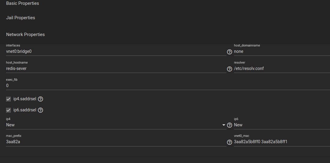

All jails and VM's are using my home 192.168.100.0 network. This is the jails config:
The jails are using static IP addresses, where the VM is using DHCP from my home router and has attached e1000 NIC interface. Upgrading to v.13 only brakes the VM networking, everything else is working. Does anything change in the new version for the settings i pasted in my first post?
