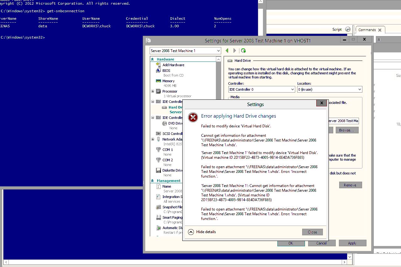

After setting up the share, i copied a VHD over to the share. When i attach it i get the classic message saying it cannot be done.
Digging around i noticed SMB 2.0 was the default max. I changed that to 3.0_00.
Same error.
If i change the minimum to 3.0, free nas is no longer accessible. Only when minimum is 2.x or below or 3.0_00 will it show freenas as being part of the network.
As you can see Server 2012 sees the SMB 3.0 protocol.

I would not bet, that SMB direct will ever work on an OSS system.
You might use iscsi.

I believe in the samba3 world smb3 is a superset of smb2. Setting min protocol to smb3 breaks stuff. Macs also tend to negotiate NT1 and SMB2 connections and so setting min protocol above NT1 would probably break samba for Mac clients. In general it's best not to fiddle with min protocol.
Max protocol is set to smb2 because smb3 is buggy and not recommended at this point. As mentioned above try iscsi instead, but having seen your hardware specs I wouldn't use that box for anything other than testing.

To be a bit pedantic (because it's what you do on the internet) I believe the feature set you are looking for was introduced in SMB3.02 (Windows 8.1 / Server 2012R2), which is still very much a work-in-progress for samba. Specifically, for VHD functionality windows will try to set resiliency on the VHD file and turn off compression otherwise file creation will fail. This means that samba needs to be able to handle SMB3.02 resiliency requests as well as fake windows into thinking compression is turned off.
These will probably eventually take the form of a VFS module. This probably means no support for VHD in Samba 4.1.x. You will have to download the current 4.2 source and compile with the correct compile-time options to get the proper vfs module. Samba releases tend to happen whenever the samba team determines it's in a good enough state for production use. Maybe we'll get VHD support by the time FreeNAS 10 comes out. :)
