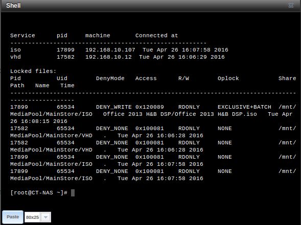

Also .... smbstatus reports my shares as RDONLY .... but I can create folders / delete files. Is there somewhere to set share permissions ? Are they separate as in Windows ? (Example : NTFS file permissions / Windows Share Permissions )
Please have a look at the attached image. Please help....
Post contents of /usr/local/etc/smb4.conf
