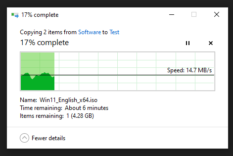

Hello TrueNAS community.
New TrueNAS user - I recently installed TrueNAS Scale to evaluate, I love the new product and the fantastic user interface and inbuilt functionality. I'm assessing whether to move my main Proxmox converged VM host and file server over to TrueNas Scale. On that machine I share a ZFS dataset from the host over SMB/CIFS and can easily saturate a 1GBE connection with a 6 disk RaidZ2 pool.
To test the system I created a Truenas Scale VM on Proxmox. The host is a DEll R710 with dual Xeon L6540 (6C 12T), 96Gb RAM. The VM is running on a Sata SSD and I have passed through a Perc H200 in IT Mode through to the VM. and I can see all drive info as required. In Truenas I've created a 5 disk Raidz1 using 4 x HGST 3Tb SAS 7200 rpm drives and 1 SATA drive. The VM is given 40Gb of dedicated RAM and 6 CPU cores. So far so good.
I've created a Dataset on the Raidz1 pool and shared this via CIFS/SMB and I'm getting very poor write (10 -13 MB/s) and read speeds (20-30MB/s). This is copying over a 5Gb ISO file. The pool is otherwise empty.

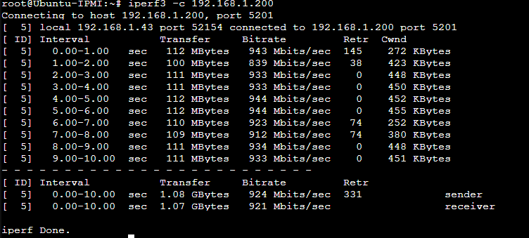

Iperf indicates gigabit network speeds to/from TrueNAS at 940 mbit/s.
I tried a pool of 2 mirrored VDEV's of just the 4 SAS drives and it made no difference. I've toggled the sync setting on the pool and again no difference (wasnt sure if this needed a reboot or pool export?)
I havent set jumbo frames yet but even without I'd expect much faster speeds. TOP doesnt seem to indicate a process bogging down the CPU.
Any suggestions on possible areas to troubleshoot?
Thanks for your help

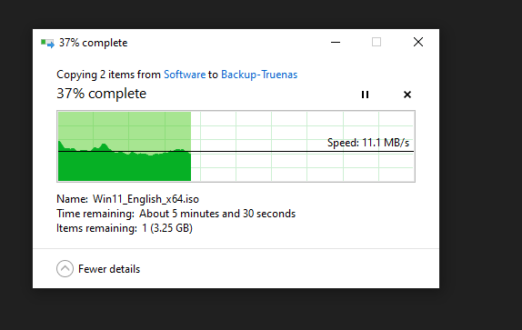

jgreco, thanks for you reply. I decided to give that a try as suggested, reinstalled baremetal on the R710, same setup this time with a Raiz-z2 pool with 5 discs, four of which are SAS2 7200rpm drives. Still getting the same very slow writes to the pool.
Copying to the pool:

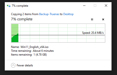

Copying from the pool, a little quicker this time, but still very slow (this is writing to an NVME SSD on my desktop machine:
Results from IPERF
I'd expect a lot faster performance here, not sure what is going on here?

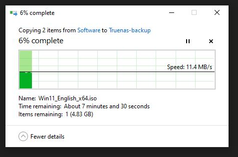

To check it wasnt the HBA I added an 256Gb SATA SSD and added this to the onboard SATA controller. I created a new single drive stripe pool in TrueNAS and shared this with SMB and again copied the same file to the new pool.
Again horrible performance, about the same speed as with the HDD pool:
So that rules out the HBA and the SAS drives as the issue. Iperf3 confirms I'm getting gigabit bandwidth. What else could be affecting SMB/SIFS?
