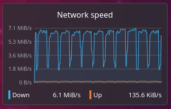

So today I needed to perform a heavy operation over SMB (namely, copy a 6GB ISO image), and noticed this:
I was careful to screenshot exactly since the transfer started, where there's a spike, followed by a dip (probably calibration of speed and negotiation of something, idk), then this rollercoaster of less-than-optimally-reliable graph... at the next Win boot occasion I'll try on there too if I see any noticeable difference between the two SMB implementations.
Or I might wait until 22.04.0 (or whatever it'll be called the next release) and see ¯\_(ツ)_/¯
