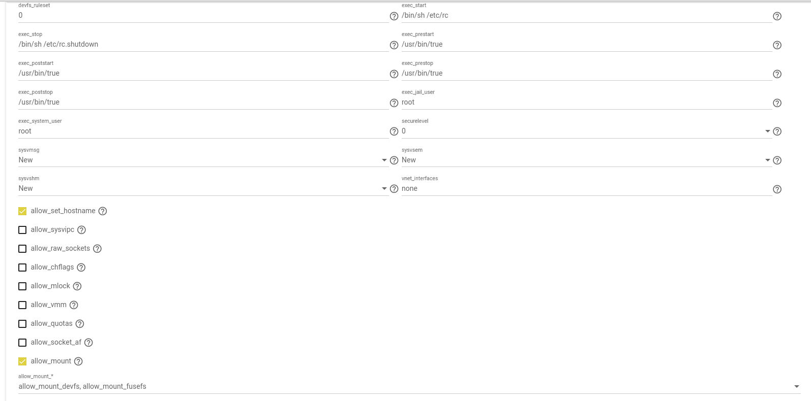

Thank you! I think I've done what you've said except that I'm missing the mount_devfs option in my jail's properties.
