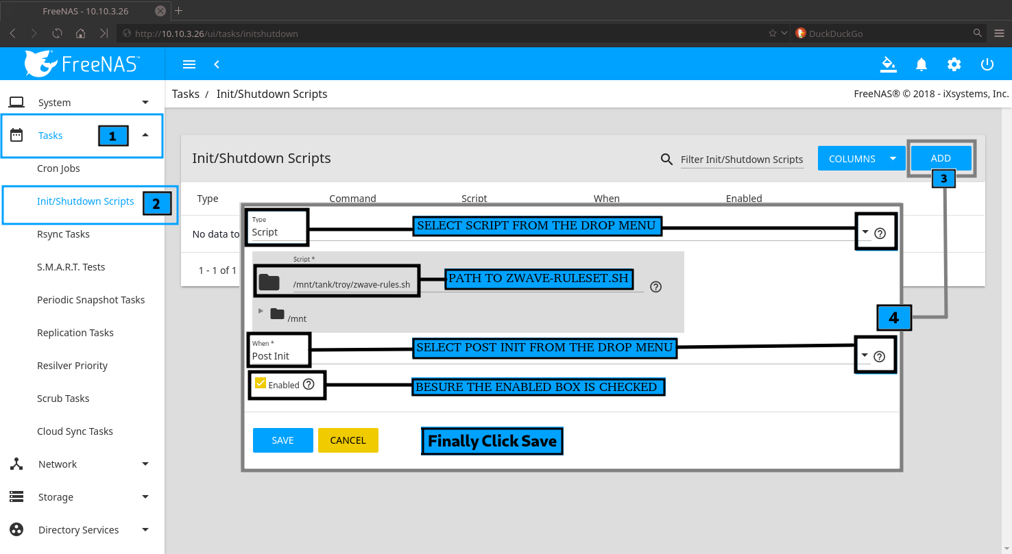

Update: This has now been solved by a quick fix in post #2 and a slightly more advanced (probably better) approach in post #10

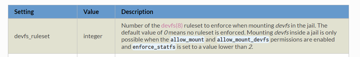

Post #2 suggests setting devfs_ruleset=3 which exposes most of the host /dev tree to the jail. This works but more of /dev is exposed than needed.
Post #10 seems to be a better approach by exposing only the cua* devices (how zwave and zigbee USB shows up). This can accomplished with a custom ruleset. Additionally this requires a FreeNAS start-up script to recreate the ruleset each time FreeNAS is (re)booted

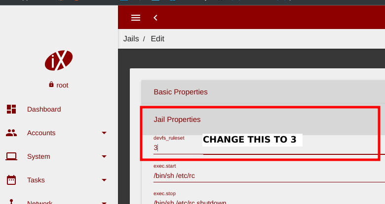

Setting my Home Assistant jail properties devfs_ruleset=3has restored the use of my USB z-wave controller inside the jail
I actually still use the command line for iocage so
sudo iocage set devfs_ruleset=3 jail-name
Opposite the web-GUI, using the command line allows changing jail properties (and mounting storage) while the jail is running. However in this case a full-restart of the jail was necessary for the change to take effect.
( -s soft-restart did not work)
sudo iocage restart jail-name
I don't even know how I figured that out (really just guessing with trail and error) but it works. Now listing all devices from the jail console seems to be the full list again

If everything is working as expected, finally add zwave-ruleset.sh as a startup script in the FreeNAS GUI.
This final step is how we get FreeNAS to automatically recreate our custom ruleset during every (re)boot.
