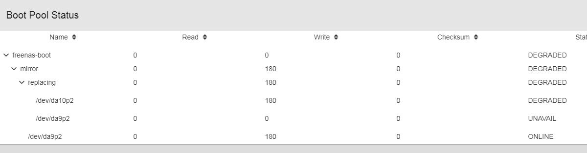

Hello and thank you in advance!
I got a warning that my boot pool (single USB) has degraded already (first FreeNAS install was August 2018, so much for longevity on this Kingston DataTraveler 16Gb 3.0). I have added another Kingston and told it to mirror. It did. Then I tried to remove the other at what seemed like a 12 hour re-sliver and it wouldn't boot now off of the new one. I reinstalled the degraded on and it worked just fine, albeit still degraded. I installed then a 3rd to replace the degraded on and keep the other as a mirror. I cannot get any of the new ones to just take over the responsibilities of the boot...so, I feel that they are pointless at this point. How can I remove the old one? I keep getting some screwed up error. Here is the error:

Not fully sure what this means. I have also attached a screenshot of what my boot pool looks like. Suggestions? The photo shows part of my boot pool is "unavailable." This I know. I just unplugged the USB. This happens whether its in or isn't so I ruled that out.

Were you able to resolve this? If not, the resilvering process can be pretty hard on USB devices (it's more geared for SSD devices). For a USB boot drive, I make sure that I always have a copy of my latest config and just do a fresh install/restore config when the stick fails. It ends up being quicker in the long run and easier on the sticks.
