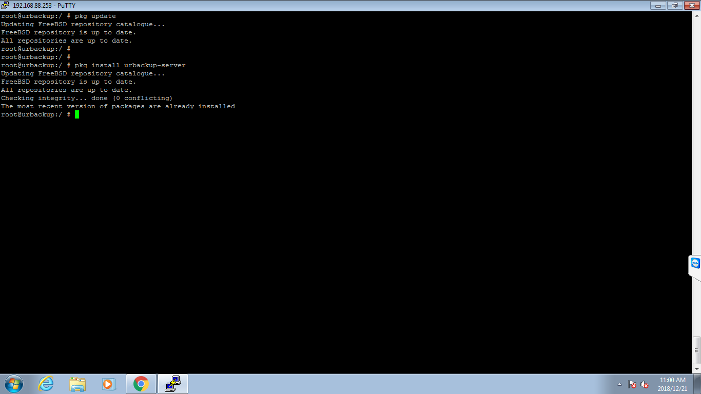

I am trying to update to the latest urbackup server but I keep getting the error below in the screenshot. I am following the instructions listed here https://www.urbackup.org/freenasserverinstall.html
I have updated freenas to version 11.2 stable and have run the following in the urbackup jail itself
pkg upgrade
pkg update
Still no luck? Seems the repository doesnt recognise the new version. Anyone know how I can get this upgraded?
Thanks

Is it not installing via the package manager because that has not yet been updated?
hervon
Apr 23, 2012
353
Exactly. Packages are always older. Best way is to compile it yourself if you want to live on the edge. ;-)
