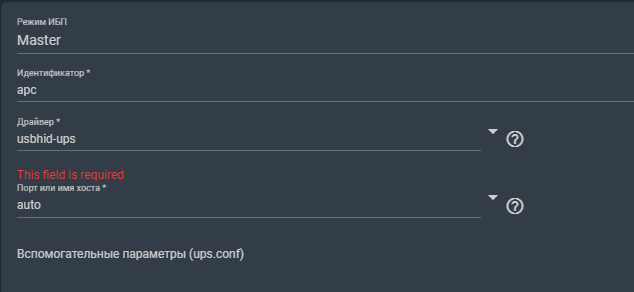

Hi, appeal to the community because I did not find information in Google.
Recently installed FreeNAS 11.3-RELEASE-p5 I decided to connect the UPS.
I have an APC BackUPS es700. When I try to configure over GUI i have error "This field is required" , in system messages
freenas upsmon[1165]: UPS [ups@localhost:3493]: connect failed: Connection failure: Connection refused
. If configure "ups.conf"
[ups]
        driver = usbhid-ups
        port = auto
        desc = apc_es700
then it working, but until the first reboot, after which the config becomes empty.
Questions:
Why does not work configure in GUI?
If it’s impossible to configure in GUI, how to make the config not clear?
Thanks!

This error does not allow to save the config via the WEB, in any logs I could not find the details of this error. And in the system log the errors are the same if you enable the UPS service without configuring the config.

Which browser are you using? i tried first with safari on a iMac, and got the same error, but it worked in firefox on my linux machine.
D'Rain
Feb 15, 2020
13
Oh, I'm stupid. How many tried to solve the problem, but did not think of changing the browser! In IE and firefox, everything works fine. The problem was in chrome on Win10.
Thanks! The problem is solved, now everything works!

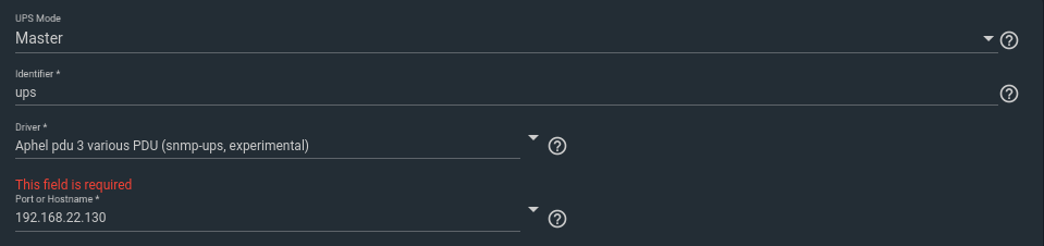

digitalo_
Feb 23, 2020
4
Switching browsers did not work for me, tried with chrome and firefox.
Running 11.3 as well and impossible to get the ups setting saved.

That doesn't work either unfortunately. I even tried IE out of total desperation but I can't get it to save.
Is there a workaround? Like editing a config file?

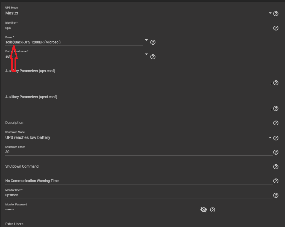

After choosing the UPS driver and coming back to the configuration page, there's a "$" at the driver's description:
Is this an issue?
Thanks.
Regards.
Is this an issue?
Thanks.
Regards.
You should check to see what's in the database. Use sqlite3 /data/freenas-v1.db or something like that I forget the filename. Then list the tables but you probably want one called services_ups. You should be able to select * from services_ups;
This will show you the value that's actually stored. I bet there is some kind of encoding error some place that deserves a bug.
zamana
Jun 4, 2017
163
Hi!
Thanks for the precise and detailed instructions. Here is the output of the select command (personal info redacted):
sqlite> select * from services_ups;
1|master|ups||3493|solis$Back-UPS 1200BR (Microsol)|auto||||lowbatt|30|upsmon|<HASHED PASSWORD>||1|1|e-mail@provider.com|UPS report generated by %h|0||15|
The "$" is there...
