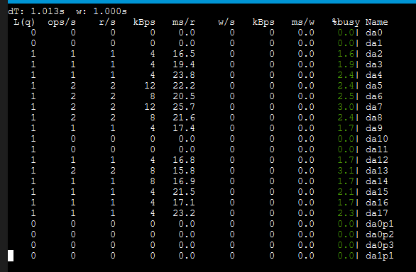

so, using gstat this is the drives mid transfer

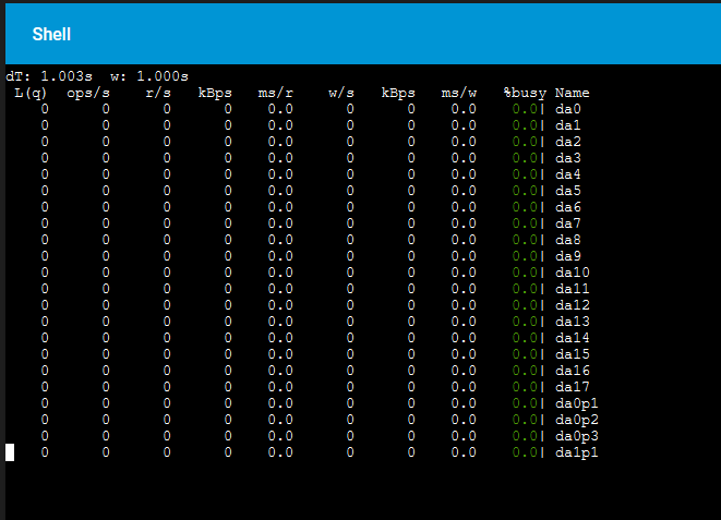

they will occasionally bounce up to something more like this
but never actually show any level of activity until the transfer jumps up to 110 mbps or so, which is the theoretical cap of my connection on the upload.

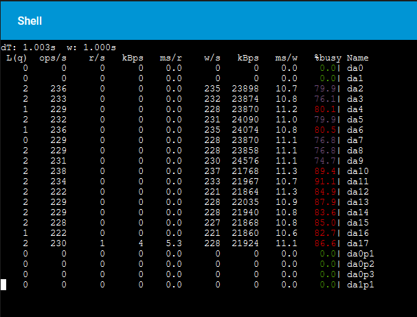

This is gstat when the transfer jumps up, not sure if it's helpful, sorry, you caught me in the middle of one of the luls and I wasn't sure when it would go back to full transfer speed. it seems to be getting worse.
