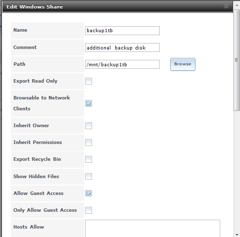

now a permissions issue
I've now got the box setup with raid z2, and managed to master putty to use SSH to then use rsync to copy the data into the raid from the usb hdd I mounted.
Now I'd like to backup some data from the raid to another external HDD. It's a small disk, 1TB, so won't fit all the raid data on it.
I can't see how to use rsync to selectively copy folders across without doing a separate operation for each folder.
So I thought I'd map the 1tb to a cisf share, and then copy through explorer. However a snag there, I can read/write to the drive I've mapped for the raid, however the new mapped drive to the 1TB hdd says I don't have permission. Yet on freenas they both have identical setup:
any thoughts on how best to manage getting data across initially, and also syncing new data to this drive in future from the specific folders it is backing data up from?
Thanks
I wouldn't rsync is better. How did you create the folder? It could be a local permissions issue.
the folder I can't access is a newly formatted & mounted UFS volume. So no permissions set on it (by me), hence why I find it a bit odd.

I also figured out what the issue with permissions was, it wasn't the permissions on the share, but the permissions on the storage volume, clicking on the icon to edit permissions next to the volume (on the storage screen) and ticking all the boxes got it working just fine. Still on the learning curve!
For other with this issue the edit permissions icon looks like this:
