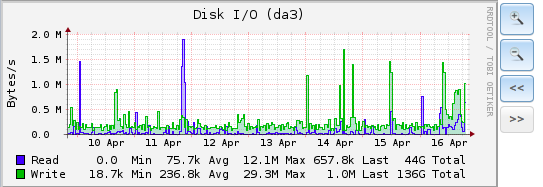

This is my typical I/O demand for my production array in home use, running 5 VMs and media players (2 users) off of this volume:
Does not even tax the system.
