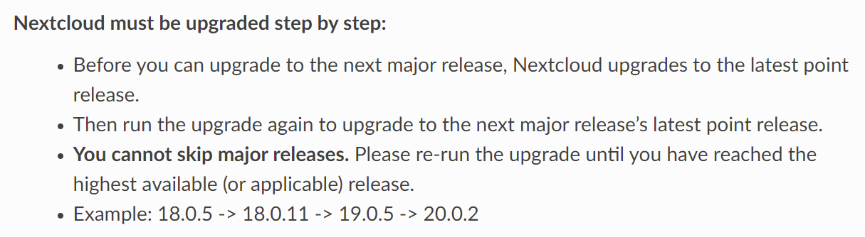

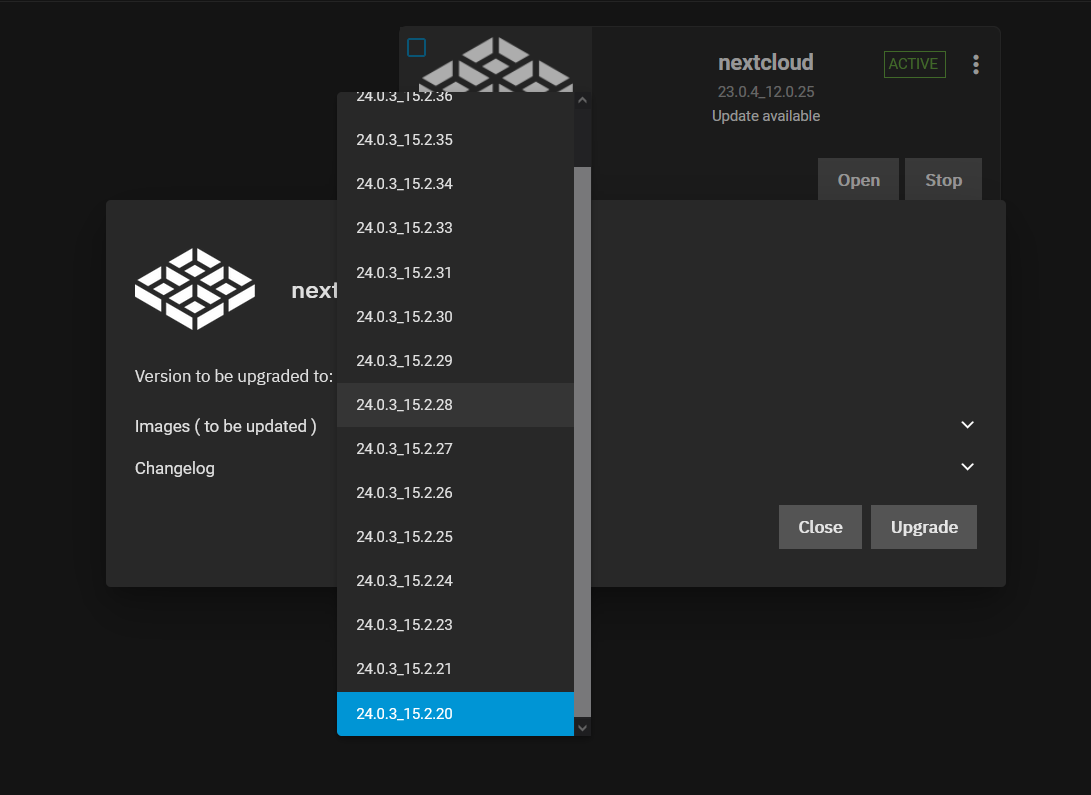

I have issue regarding update of Truechart's Nextcloud on TrueNAS Scale, let me explain little bit:
I'm currently on version 23.0.4_12.0.25 and would love to update to lastest version and due my absence form home lab I didn't regularly maintain and update so now I have a problem that I don't know how to solve.
Recomendation from NextCloud is to update all minor version to seccesfuly update to lastes version,
but, as you can see, I don't see every version on dropdown menu and if I update on any version my NextCloud isn't accessible any more
Is there any solution @Truechart or anyone else? :)

It won't work. Your best option is to backup your data and re-create the application.
Truecharts went through many breaking changes from helm chart version 12.0.25 to what the latest version available is. Because of that, you'll unfortunately have to either stay at the older version, or backup everything and restore it.
You can backup and restore pretty easily using Heavyscript, if you're using PVC.
If you need help restoring let me know, I've done it like 6 times.
