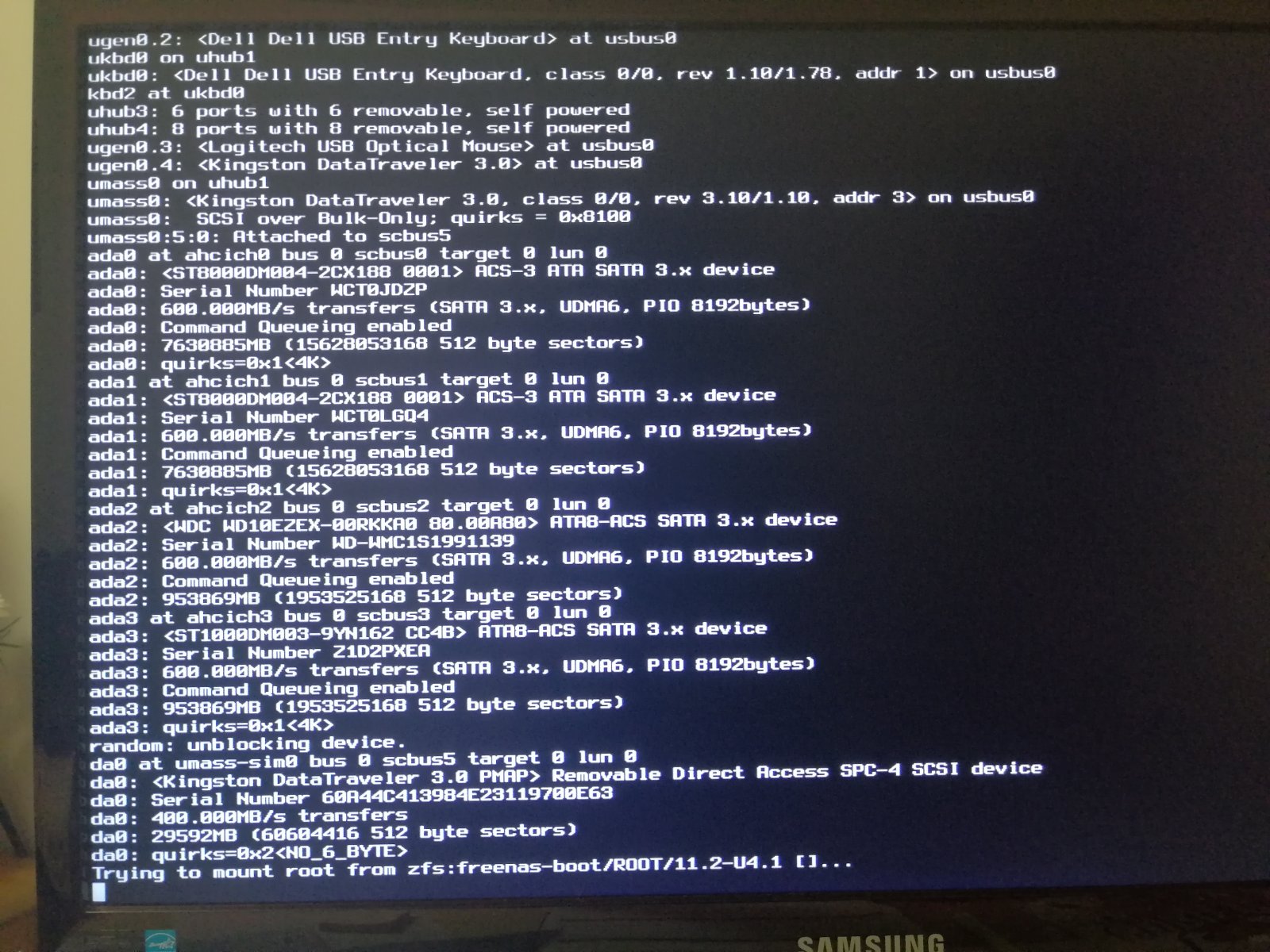

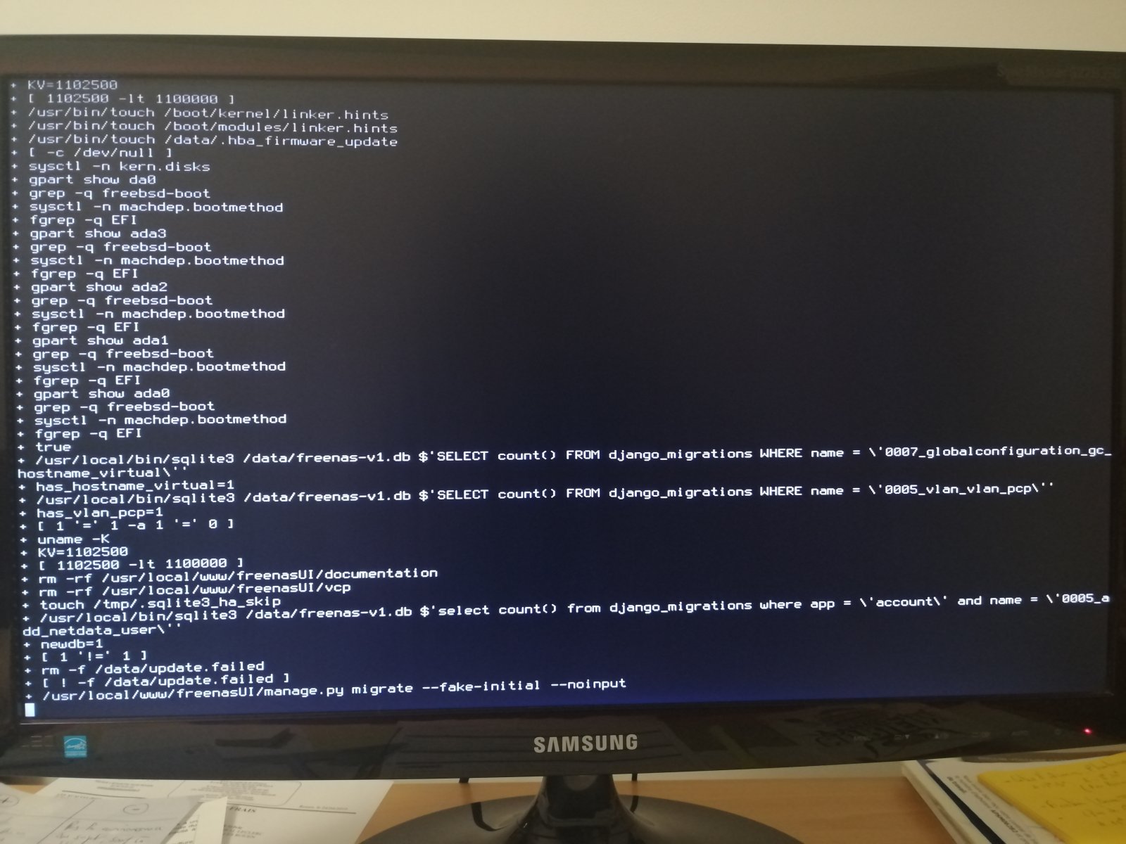

BUT, the upgrade to 11.2-U4.1 failed !! :eek:
I waited 15 minutes after the automatic reboot. He wasn't coming back on my network. So I turned it off to connect the screen and keyboard. And here's what I find, after another 15 minutes of waiting:
It gets stuck on it.
What should I do now? Download the 11.1-U7 iso, install it and reload the backup? Or is there something else to do?

If you watch the boot, at the very start there should be a menu where you can choose to do something other than boot FreeNAS. I can't recall exactly how it is formatted, but there is an option you can access from the boot menu that will let you boot back into the previous environment without needing to do a fresh installation.

Indeed, there is a menu that looks like Grub (if not Grub itself).
So I successfully restarted on 11.1-U7.
What should I do next? Try the update again as if nothing had happened?
Kuo
Nov 3, 2018
22
I tried again to update and it worked successfully.
