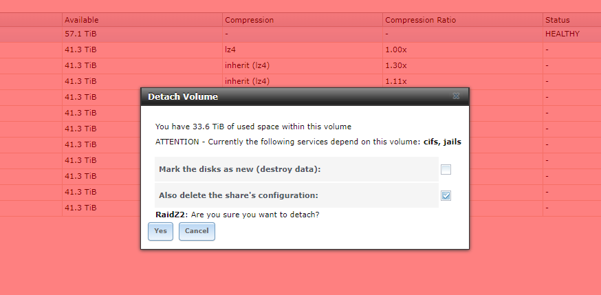

Done all that, by the last one do you mean storage > volumes > detach volume?
9,700
Yes, make sure that you don't tick the box to destroy the data.

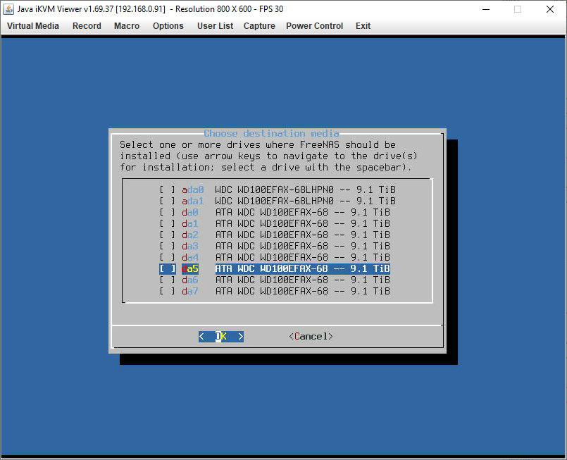

I'm trying to install FreeNas into the USB stick but i don't see it under destination media but it must be there as it just boot to the install.
Do i need a second USB stick for the bootable ISO and an empty drive to install it onto?
9,700
Yes, or put the install on a CD if you still have a drive.
Another alternative is to do the install on a Virtualbox PC with the (blank) USB passed through and the ISO mounted directly as a CD in the VM... then shut it down and transfer to the hardware when done.

Thanks guys I had a newer 32GB USB drive doing nothing so i just inserted that instead of the one i had been using for 4 years.
I managed to install 11.3 and import my pool, now to look around for guides on how to get my plugins back and learn this new UI.
