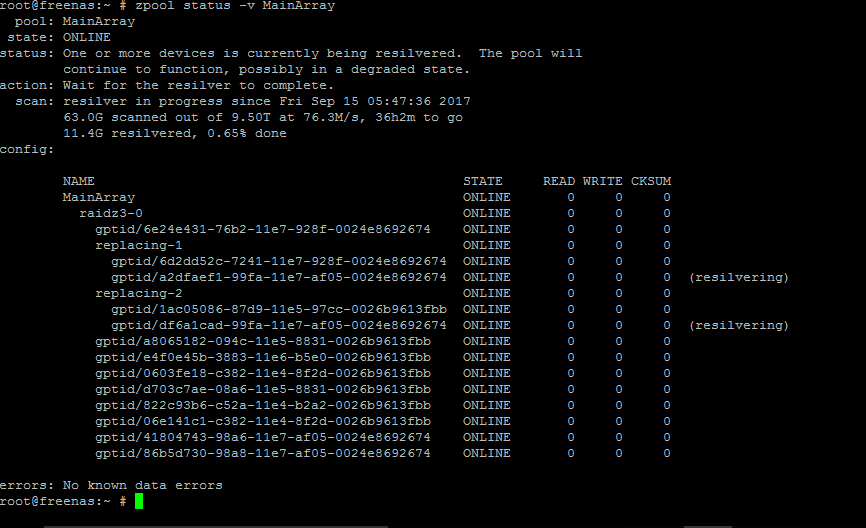

Hello everyone!
Been running FreeNAS for 3 years now, love it. I have an 11 disk Raid z3, and right now I am resilvering 2 disks at a time ( I know this may not be safe, but all my important data is backed up to CrashPlan Pro). My NAS is at capacity, only 80GB of free space. I have 64GB RAM, 2 x XEON E5640, 11 x HGST 1TB Disks in RAID z3, Upgrading to 11 x 2TB HGST disks.
I have 2 questions:
1. Is there any way to correlate the disks, to their location in the NAS. IE Bay 1 is /dev/sda1, etc... I know I can put that in the disk Description, but I am still curious.
2. It takes about 36 hours to resilver 2 disks. At the current rate of 2 disks every ~ 36 hours, it will take almost 8 days to complete. Is there any way to speed this up?
Thanks!
3 UPDATES:
1. If you add a disk to the resilver process, IE, your resilvering 2 disks, and add another, it starts the process over entirely!
2. If you offline a disk, and replace it, you CANNOT add the original disk back into the pool in the event of a failure, at least not from the GUI.
3. It appears that the number of disks you resilver does not affect the speed of the resilver process
So, just some usefull data based on my setup, that may help someone in the future. It could be that I have one bad disk, but we will see soon, and I will give another update.

I do have one other question regarding replacing disks; If I am 50% complete on a resilver job, and I add another disk, and begin a resilver on it, the % complete resets to 0%. Are the other two disks still @ 50% and this one is at 0%? I ask, because I started to "In Place" 2 this morning, but would like to pull 2 disks, and add 2 more to the job, now that i know I can do that.
Also, is there anthing else I should be aware of when offlining two disks, AFTER I have already started a resilver?
I believe so, but not sure.
As long as you still have one disk of parity, its pretty safe. If you have a disk failure... add back one of the offlined disks and it will resilver very quickly to restore full redundancy.

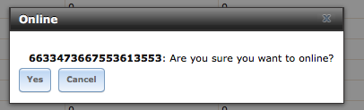

How can I online a disk I have removed on the fly if I need to? I have never tried that.
Stux
Jun 2, 2016
4,419
Trick is knowing which disk by Serial Number matches up with the ZFS id.
Good notes would help. Alternatively, you can look it up somehow...
Ie, so you know which disk to online...
Actually... it shouldn't matter... just put any of them back and try onlining all of the offlined disks, FreeNAS will figure it out.

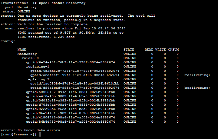

Yeah, more curious about the GB/s resilvering rate you end up seeing
siconic
Oct 12, 2016
95
Right now, around 90MB/s. I wish it was GB/s, this would take no time at all. I am pretty sure it is because of the 1TB disks, they were pretty slow. I think these are a little faster, but they are still only 300MB/s.
