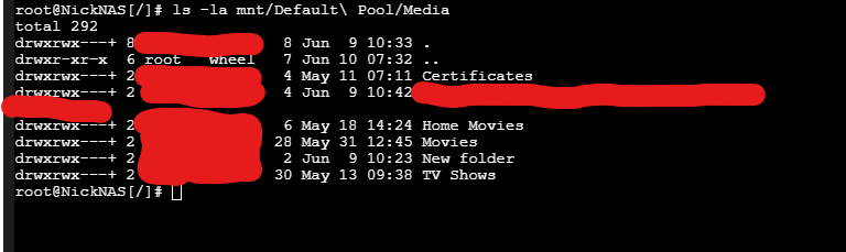

Here is permission over my media pool. I blocked out some personal data i had in the data set, the red marks are user account permissions assigned to the folders inside the dataset. I think maybe the fact that root has ownership might be an issue.

I was able to reclaim permissions via SMB by executing the command : setfacl -m everyone@:rxaRc::allow /mnt/Default\ Pool/Media
(I know I know, but I was pulling my hair out trying to get permission to edit data sets)
Now my problem is my Plex server cannot read media files.
Will post back if I get it fixed.
