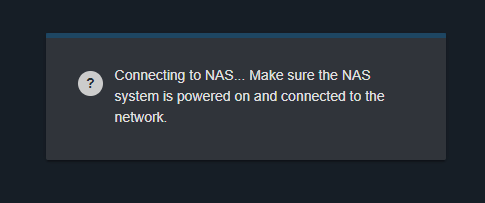

OK so I checked the attached devices on my router. None of the connected IPs allowed me to access the webportal. However when I go to the original IP I get this message:
So does this suggest that IP is still being used?

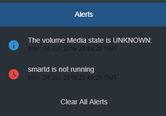

OK I'm in! I had to connect a video card and tell the bios to configure the network so it would assign an IP.
But....
Now none of my disks are showing up. The only disk there is the thumb drive with the OS on it.
I have two alerts:
Not sure how to proceed.
