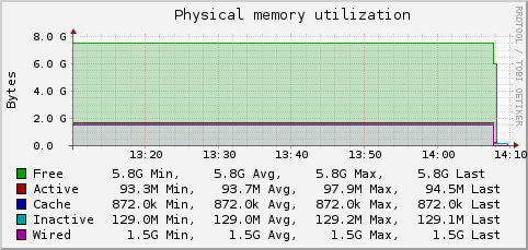

I'm using the Beta 8.2.0. so after you changed these settings do you actually see in your graph that freenas uses more than 2GB? funny thing is I do notice an increase in performance mostly with browsing and copying files but i just don't see it in the physical memory utilization graph. All the cache, active and wired usage stats flat-line at just a hair under 2GB.
Yes, copy a large file of several GB's and you'll see it increase over 2GB, slowly in my case. I was expecting a better scrub time also, but mine was actually worse.

Hi guys, sorry for the delay This defiantly worked!! :) I haven't quiet used the full 8GB yet but it is for sure using more than 2. I think its because i just don't hammer my Freenas that much I just use it mostly for file sharing. Weird how it uses the utilizes the memory in the screenshot i was copying over a large amount of files, I would have expected the Cache to spike or something but it seems to steadily rise ever so slowly. I'm guessing because it is building its list of frequently used files and storing them in the cache. As far as performance goes this helped A LOT! most of the pauses and slowness are gone when i am browsing through my directories, I still get the occasional freeze up when browsing through my files but i used to get that even when i had a windows file server, I think its probably my switch or something. Thanks again for all the help! If i may make a suggestion I would change the name of the "delete" button in the system tunables to "Regenerate" and turn Autotune on by default.
