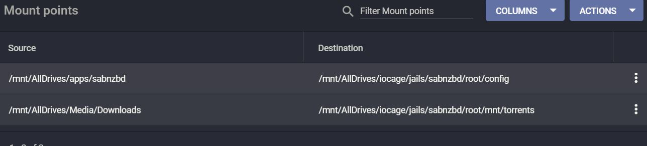

My research says that that path was sent to Sonarr by Sab and that It is a path relative to Sabs jail, not sonarrs. Sab has a mount point to outside its jail of
/mnt/AllDrives/Media/Downloads

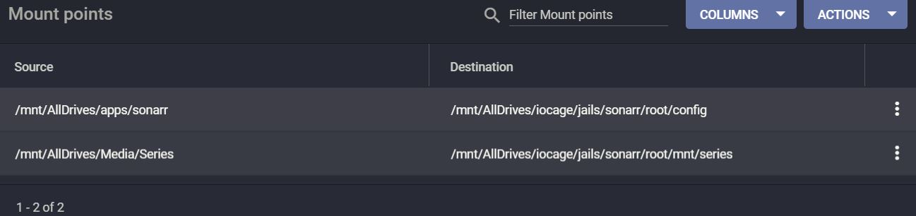

Current jail mounts
Sabnzdb
Sonarr

You don't have a mount point to /mnt/AllDrives/Media/ set for your sonarr jail. If you did this single mount point then you would just need to make sure that the folder names match in both /mnt/AllDrives/Media as well as /{jailname}/root/mnt/
Since you have your app configs set as mount points I'd suggest installing Sonarr inside the SAB jail to keep settings and configs simple. It'll save a little bit of resources as well to just be running one jail rather than two.

Thanks deidrichg. I figured that was it since Sab had mount point to outside the jail and downloaded files were visible at that point outside the jail. However, I also noted that the mount points for Sonarr were to the series folder (final resting place outside the jail) but nothing to where Sab had the completed downloads. You have confirmed what I thought but I'm still getting my head around Source and Destination on mount points.
