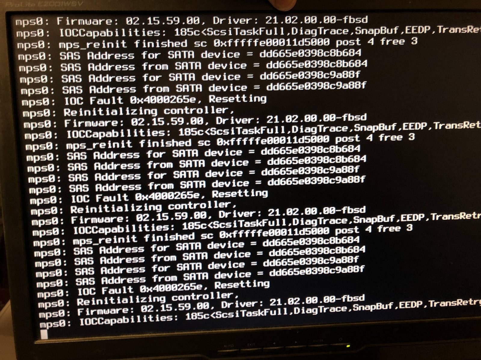

Hi
Upgrading to 11.1 from 11.0-U4 on a Dell R710 failed to initialize the PERC/H200 SAS Controller on boot. The boot sequence was caught in a loop trying to initialize the controller but failing with an IOC Fault 0x4000265e (see screenshot).
Reverted back to 11.0-U4 all working fine.

I have the EXACT same issue with my T610. Has a solution been reached?
Dec 17, 2017
3
Hi Yes, this has been fixed and in the bug report, the H200 card needs to be flashed into IT mode. You should be able to find how to BUT the most importing thing I found out was to Flash the card on the Dell hardware. As I tried on a test rig which worked fine and worked on the test rig but Dell boot checks FAIL.
