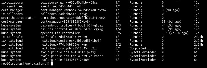

I had been using Pi-Hole on Truenas Scale for about a year until upgrading from Bluefin to Cobia (Version:23.10.2) in February. I struggled some with Nextcloud and Syncthing after the upgrade but got both of them running without reinstalling them. Pi-Hole (TrueCharts version) on the other hand did not survive. Other apps will install OK, but since the upgrade TrueCharts and TrueNas versions of Pi-Hole will not install they both fail with the following cryptic error message.
[EFAULT] Failed to install App: Error: INSTALLATION FAILED: create: failed to create: secrets "sh.helm.release.v1.pihole.v1" is forbidden: unable to create new content in namespace ix-pihole because it is being terminated
Anyone have any ideas how to FIX this error???

Sounds like your app is stuck in limbo... check with k3s kubectl get pods -A if it really is stuck. If it is stuck you can try to delete it with sudo k3s kubectl delete ns ix-appname (replace appname with the name of your pihole app) and then try installing it again. It could be that you have to press save twice during the app creation

I ran "k3s kubectl get pods -A"and the last three lines that appeared seemed to be Pi-Hole related. I then tried try to delete it with "sudo k3s kubectl delete ns ix-pihole" and received namespace "ix-pihole" deleted not sure if it did anything as the pods display still has the same three lines at the bottom and the app still fails to install with the same old message as above.
