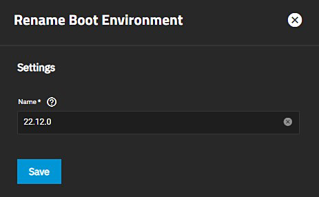

Renaming a Boot Environment
You can change the name of any boot environment on the System Settings > Boot screen.
Click the more_vert for a boot environment, and then select Rename to open the Rename Boot Environment window.
RenameBootEnvironmentSCALE
Enter a new name using only alphanumeric characters, and/or the allowed dashes (-), underscores (_), and periods (.) characters.
Verify the boot environment in Name is the one you want to rename.
Click Save.

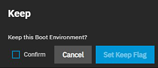

Keeping a Boot Environment
Keep toggles with the Unkeep option, and they determine whether the TrueNAS updater can automatically delete this boot environment if there is not enough space to proceed with an update.
Click the more_vert for a boot environment, and then select Keep to open the Keep dialog. Select Confirm and then click Keep Flag.
KeepBootEnvironmentSCALE
The boot environment action list removes the Keep option and adds Unkeep.
UnkeepBootEnvironmentSCALE
This makes the boot environment subject to automatic deletion if the TrueNAS updater needs space for an update.

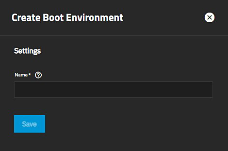

Adding a Boot Environment
You can make a new boot environment to your TrueNAS.
To add a new boot environment, from the System Settings > Boot screen, click the Add button to open the Create Boot Environment window.
AddBootEnvironmentSCALE
Click Save.

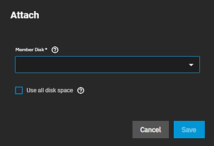

From the System Settings > Boot screen, click the Boot Pool Status button to open the Boot Pool Status screen. This screen shows the current operating system device (boot pool), the path for the pool, and the read, write, or checksum errors for the device.
BootPoolStatusListingSCALE
Click the more_vert to open the Actions options.
BootPoolStatusAttachDiskSCALE
Click Attach, then select a device from the Member Disk dropdown.
Select Use all disk space to use the entire capacity of the new device.
Click Save.
