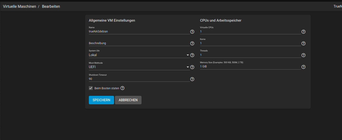

peterwyss
Feb 20, 2021
I have the same problem, but I can't find a setting for bind.
