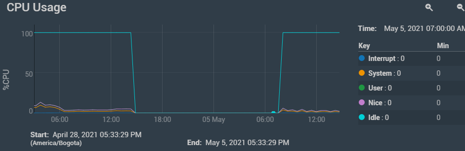

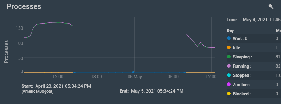

UPDATE
the system is running normaly, not crashed, not slow after update and disabled some shared folders to limit the connection to the server.
