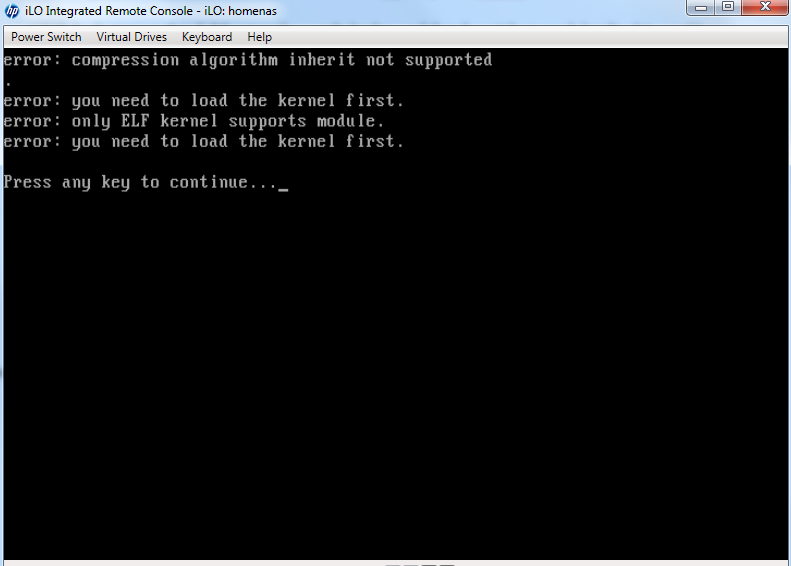

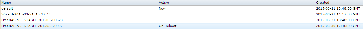

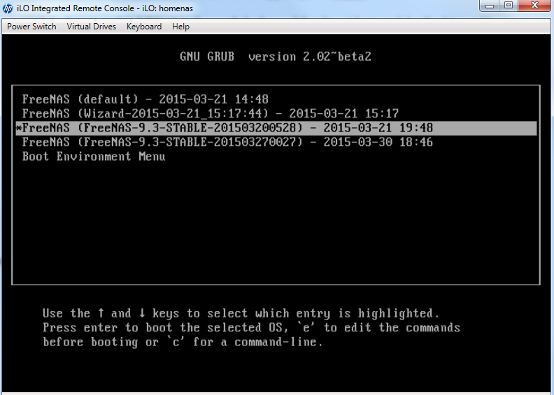

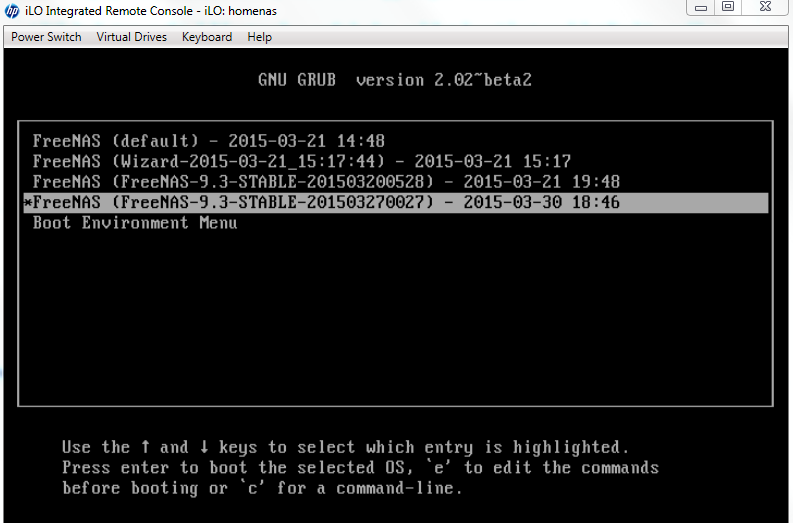

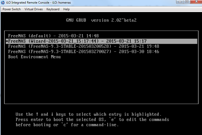

Did a couple of upgrades and now it won't boot either of the upgrade boot options. It failed the wizard boot option dropping me in kdb on the first attempt. Second attempt worked.
Boot device is mirrored. 1 internal USB 16Gb SanDisk stick + 1 PNY microsd 16Gb card.
Boot volume is shown as healthy in WebUI. Mirror shows up as online. Able to boot default and wizard options in GRUB. Config looks stock in either successful start-ups. Installed several plugins and the jails are gone in the UI (assuming the config is gone, so the info on the installed jails as well).
Need instructions on how to debug further. This is a home system so I can run whatever steps are needed to collect data on the problem, if there is one.
Screenshots of what I've considered relevant are attached. Error on compression algorithm inherit not supported is shown for either upgrade boot options.

Dmesg confirms the boot is done from the mirror as far as I know from what is shown. And this works right now on my system. The errors I've captured in the screenshots are after grub loads and a selection is made to boot. I'm stuck at kernel load from what i'm seeing. The kernel image fails to unpack and grub errors out.
