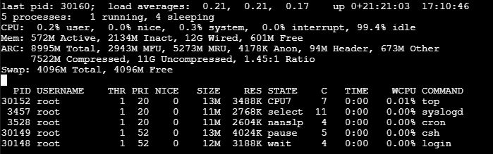

so at the same command prompt run top and see if its running.
Dellyjoe
Jun 12, 2020
80

Yep so I bet its not truly "starting". If its me im guessing that the web GUI ran into some permissions issues along the way. Try this at the same command prompt..
pkg update && pkg upgrade -yf This will reinstall all packages including sonarr.
chown -R sonarr:sonarr /usr/local/sonarr /usr/local/share/sonarr Sets the directory owners back up as sonarr, its feasible that this could be different for you, but unlikely.
service sonarr start
netstat -n | grep 8989 and or top See if its running now?
