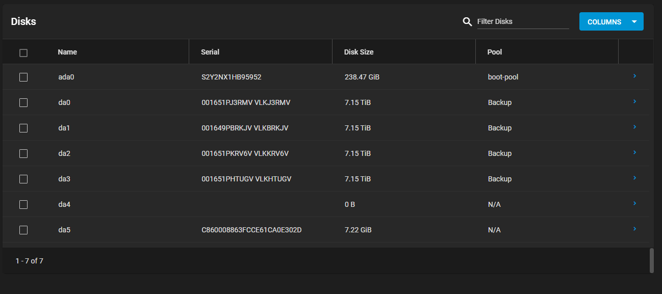

Running on 13-U3.1 everything was great on my second NAS, no issues
Upgraded to 13-U4, and none of my data disks show up! They did however show up in the LSI list from the HBA booting when the system was turning on. Went back to U3.1 and still no disks.
What is the best way to go about figuring out the issue here? The only thing I can think is that this card is on pretty old firmware, and maybe the U4 added a new driver that removes support? But, then going to U3.1 should work again right?
If I do sas2flash -listall I get a message about no LSI Adapters found
But, If I do dmesg | grep mps I get this, showing me that the card and disk are there!

How can I figure out why these disks don't show?
The boot log also shows it syncing 7 disks, which I think is correct

Samuel Tai
Apr 24, 2020
5,399
You may need to manually import your pool. Go to Storage->Pools, and click the blue Add button. Select the existing pool radio button.
HarambeLives
Jul 19, 2021
153
Sadly nothing there listed, and under disks in the UI all the SAS disks are missing
Samuel Tai
Apr 24, 2020
5,399
Sounds like your HBA may have given up the ghost.
HarambeLives
Jul 19, 2021
153
I'd agree if the BIOS for the card didn't show everything
I just did a fresh install of 13 U3.1, and now they show up. I'll be sticking on 3.1 for a while
I'll add updating my firmware to a newer version to the list too!
