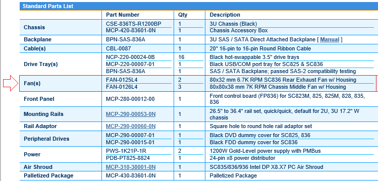

So I just got the SC836BA-R920B case and.. I don't see any way to mount the 2.5" drives in the back? Did you ever figure out how you're supposed to do that?
Fuganater
Sep 28, 2015
477
Looking here it does not look like there is a mount like the SC846 has. There are plenty of PCI solutions out there for HDD or SSD. Most recently one posted by @jgreco here.

I was wondering if you were experiencing the same thing here.. I have the very left chassis fan plugged in FANA (bottom left on the motherboard, if I/O panel is top right) and the CPU fan in FAN1. Now the funny thing is when I change the fan speeds from "optimal " to "Heavy I/O" in IPMI, only FANA (very left one) goes high up (~3900RPM), the rest of the fans only go up to like ~2900RPM. Do you see the same happening for you? Are we supposed to plug in CPU fan in FANA instead? Just seems kind of weird only FANA increases in 'Heavy I/O'...
Bidule0hm
Server Electronics Sorcerer
Aug 5, 2013
3,710
Yes, it's normal. In Heavy I/O mode you want to increase cooling of drives/backplanes/HBAs/... but not the CPU.
