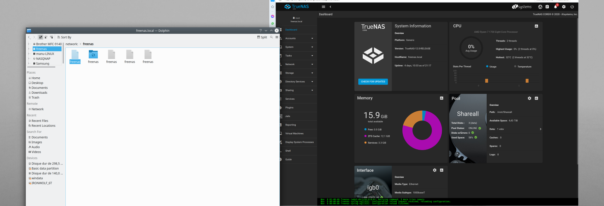

My freenas is avaible from windows only and when I try to reach it on Linux it shows me 4 grey icons and one blue one.
When I click on the grey ones it opens a window in Dolphin with "freenas.https" and on the blue one, it opens my browser and shows:

To make it clear I have made a screenshot. You will see that I still have access to the NAS through web browser.
