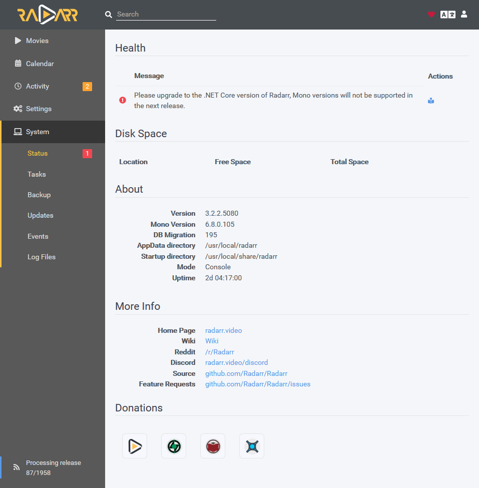

Hi !
I am confused because I have the version of mono you wish to install, yet I still have the same error (see screenshot), shouldn't we figure it out the latest version ?
btw i wish i could help you right now but i can't remember exactly the tortuous path i used to install mono (i will be looking in my bookmark)
EDIT
Okay found out, i used his advices https://www.digimoot.com/truenas-sonarr-v3/ to help me install v6.8.0.105
