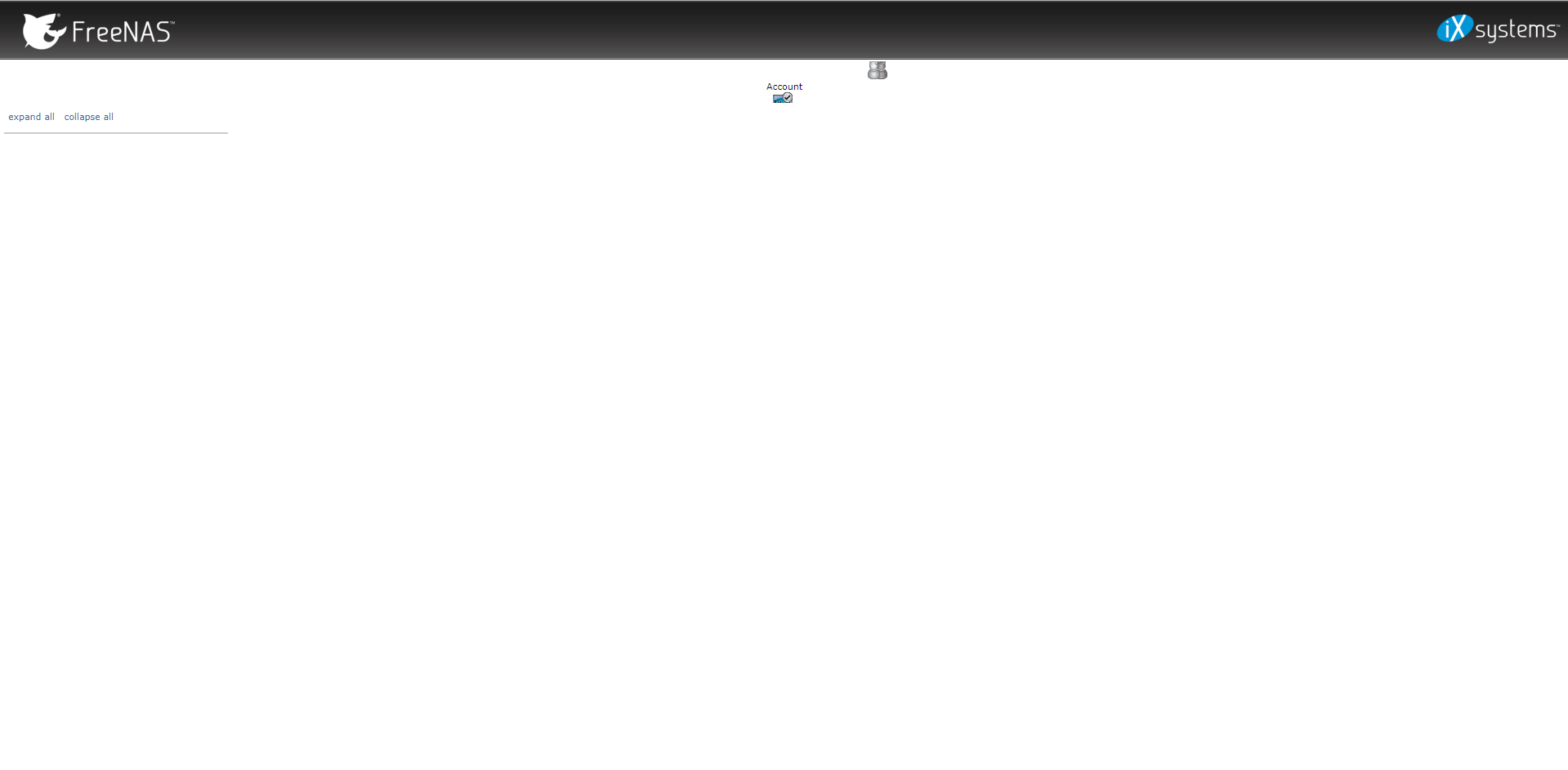

Anyone else have any issues when upgrading from 11.1.U4 to 11.1.U5 with SSH shutting down and the Web Login screen basically blank and no icons etc.?

Clear your browser cache.

I have tried now on Chrome, Firefox, and IE with the same results on all browsers after clearing all browse history etc.

What are you using for a boot device? Do you have a copy of your config saved from before the update?

I have an internal USB Thumb Drive with the OS installed. I was able to console in and fail back to 11.1.U4 and everything came right back up and working again. I am holding off on any more upgrades for a while.

U6 is out right now, so you might as well give that a shot.
